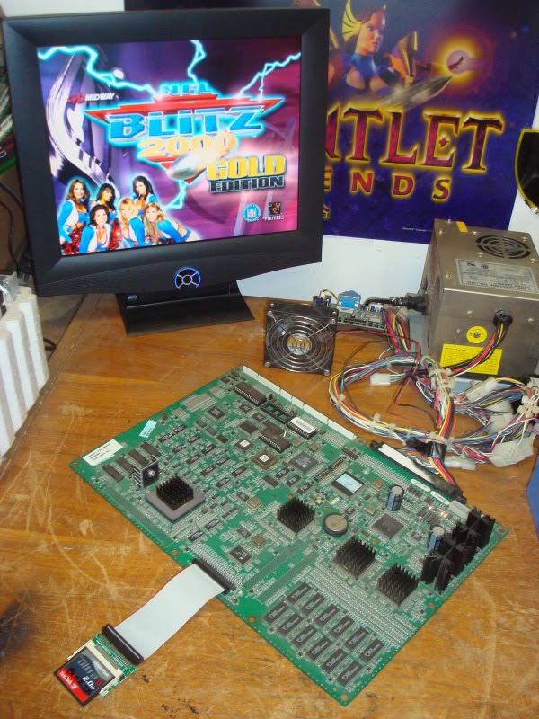

Is upgrading a hard drive to a Compact Flash card really an upgrade?
I originally posted this in another one of my threads, but I felt it needed it's own thread just for the record.
The original Blitz/Showtime hard drive is a Quantum Fireball lct. According to research, this drive has the following specs:

Now a lot of people have updated their hard drive based arcades with Compact Flash cards. The fastest speed CF card I can find features a 300X 45MB/s speed - which is actually slower than the original 66MB/s. Granted, these are two different technologies so real world CF speeds may in fact be the same or faster, but there doesn't seem to be any confirmation on this. The CF card update may be suitable for the likes of Killer Instinct as those might have used slower drives, but it may actually be a downgrade for newer hard drive based games.
Can anyone here confirm, or do a test between the two drives to determine which is actually faster?

Blitz 2000 Gold / Showtime Gold - upgraded to CF and the game actually boots faster than with the hard drive. there are not any large files for any sequence that slows down the game. I am using a 4gb Sandisk Extreme III. Even switching between football and basketball is not noticeably different, I would say the CF is faster but I never did time it as it has been several years since the conversion.

Thank you matt. This is what I was looking for. Now with this information, the speed of the device used hardly matters. However I do want to point out one last thing just for the record. Choosing between a HDD and a CF card as a replacement still remains a personal preference, and I'll explain why.
Depending on the situation, and how often the game will be used, a hard drive may be better in certain situations. I, personally, am a collector. However I don't use the arcades I have that frequently. Make no mistake, I love them, but I'll play them when I have friends and family over, I'll play a few games every now and then, etc. Sometimes I'll play them for a few days, sometimes I won't touch them for a month or two. If I kept this behavior up for 10 years, the hard drive would outlast the CF card. Take this for example: If these machines shipped in 1999 like they did, but with CF cards already in them, then right now I would be replacing the CF card in there not because I want to, but because I have to, as the CF card loses it's data retention after 10 years. The hard drive wouldn't have this problem. Think of CF cards like a CPS2 suicide battery that lasts 10 years, and if you forgot to backup your drive, that information is gone.
Now in this situation, a CF card may be better: Say you have people over on a regular basis, you play these games by yourself frequently, or you have them all on at once for one reason or another. This is where the CF card would be better. If you play these games frequently a hard disk will begin to fail much sooner - the majority of the wear and tear put on the drive is when it's turned on and off frequently. Also, depending on the cabinet, it may be better to use a CF card as a new hard drive will heat up, and if the proper cooling isn't installed this would also lead to failure.
So now we know that speed isn't an issue. I've had my question answered, and I hope this thread has helped others as well! Thanks to everyone who chimed in :)
