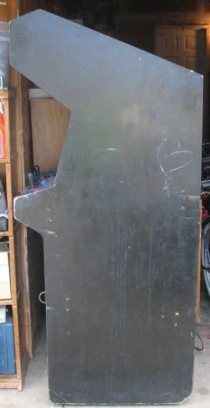

First off , I'm not even sure this is a Dig Dug . It has a Namco sticker on the back , Centipede and Kangaroo had nothing to do with Namco , right ? I originally bought it just for the monitor but have been thinking about what I should do with it . I read about using Goof Off Graffiti Remover and was thinking about trying that on the sides . I can see some white on the edges from the original art . Theres several small holes that were drilled in the sides , not sure what those were for , maybe security bars . Not looking to make it Mint , just a decent Dig Dug .
So I would need a new CP , this ones been hacked , Bezel , Marquee , PCB board , which I'm thinking all this would be about $200 , sound about right ?
Or should I just pass and find another clean original Dig Dug and not bother since they are a pretty cheap , common game .

I have a Centipede and a Dig Dug that I picked up a while back that were in considerable condition. Amazingly enough, the Atari sideart is pretty damn durable. I used 3M Safest Stripper to take off the paint and it looks pretty good underneath. If you take your time, you can scrounge together parts pretty cheap. Most people will probably say it ain't worth it, but I am a sucker for punishment.....

arcadeannex - got any tips on using 3M Safest Stripper ? Did you try the Goof Off Graffiti Remover ? I guess I'll try removing the paint and see if the side art is any good and go from there .
If there is decent Dig Dug art under that I would make it a dig dug, the parts should be cheap. Otherwise 48-1 Dat!!! :eek:

I would say, try cleaning it. Sometimes that black paint will come off easy (scratch it off with your finger nail). Sometimes its on to stay. I put a ton of work into stripping the paint off a crystal castles and it came out ok. It was just too much work. Won't be doing that again..

The question is, why do you want to do it? Are you hoping its a dig dug? You do realize you could buy a working dig dug for around $300-$500?
If you really want to save a dig dug, I have a marquee and montior bezel. I have a kangaroo control panel and I am pretty sure its the same as dig dug.

I hope its a Dig Dug , it does have that Namco sticker on the back .
But like you said its alot of work removing the black paint and I've never done it before . I don't really like chemicals and the fumes .
Well I'll give it a try and see what happens .
If the paint comes off and the art is good I could definitely use those Dig Dug parts , it will save me alot , not having to pay for shipping . I'll let you know what happens , if I need them .
