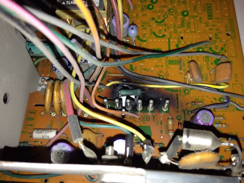

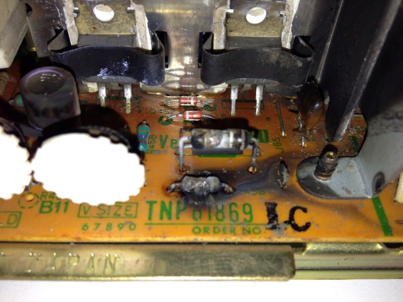

I picked up a Kangaroo today off of craigslist. When I powered it on, there were flames on a resistor and a diode(?). Pulled it out and it burned a hole at the yoke! The flyback visually looks fine and the original wiring looks intact so I assume it's hooked up to a ISO. Should I even try to fix this? Any guesses of what could have happened!? Tube has no burn in so would be nice to get it working.
Resistor in the front that was in flames
Yoke
Underneath the yoke.

Holy bejeezus, that last picture! I've set a monitor or two on fire, but that is awesome.

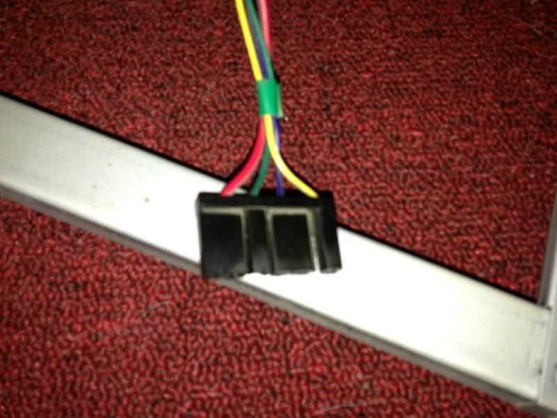

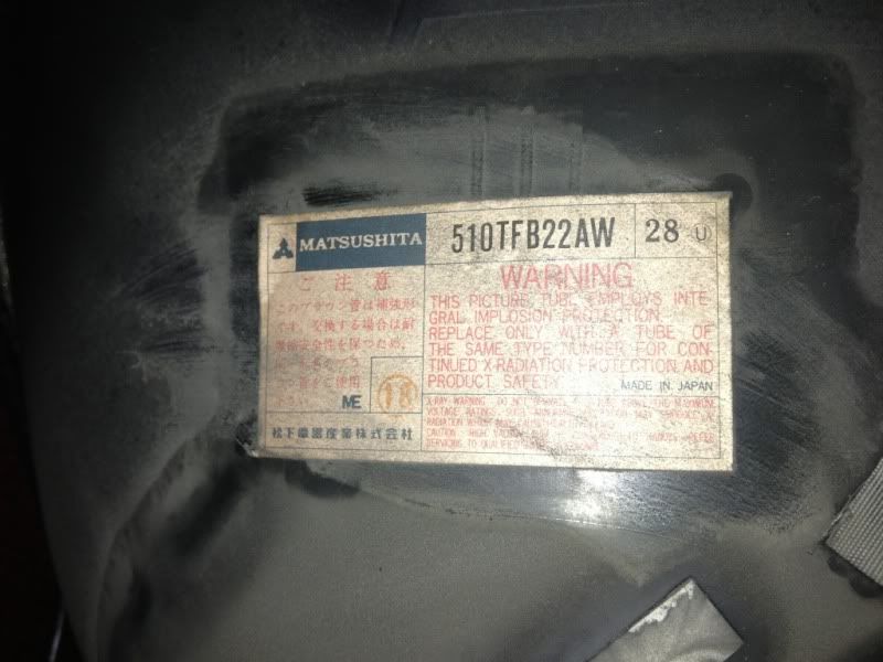

What's your tube number and the measurement on the hori. and vert. of the yoke?
Green and yellow is your vertical. Red and blue is your horizontal. Take your meter and put it on ohms and stick the leads into the connector of the paired colors listed or right off of where they are soldered on the yoke. Nothing specific but maybe if you can't find the exact chassis we might be able to find you some other replacement.
that yoke will not work with any other chassis in the arcade world. the readings are to far out to be even close to anything else
again this TUBE is USELESS for any other arcade monitor chassis.
it is an oddball that no other manufacture of arcade chassis used it is a one of a kind.

Man, that was a gnarly failure. I've seen traces blown off a board before, but I haven't seen holes blown through boards. Something has gone serioulsly Elvis on that one!
I've seen D9200's with half dollar sized holes in the board.
OP, that monitor is useless. Those tubes suck too so even if you get a working chassis theres a good chance that the tube is weak.
My guess would be the HOT and/or the flyback had something to do with that failure.
I re-capped a chassis that had a quarter size hole in it... Was still working fine. Someone had epoxied on a perf board that had one or two components on it.
Still working good..... I need to find the pic of it now...
