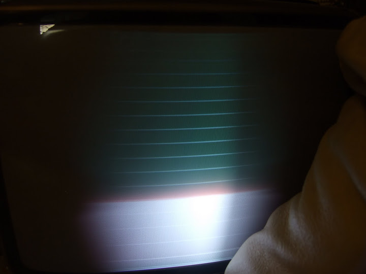

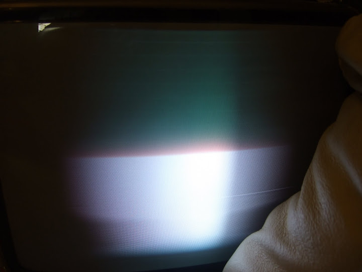

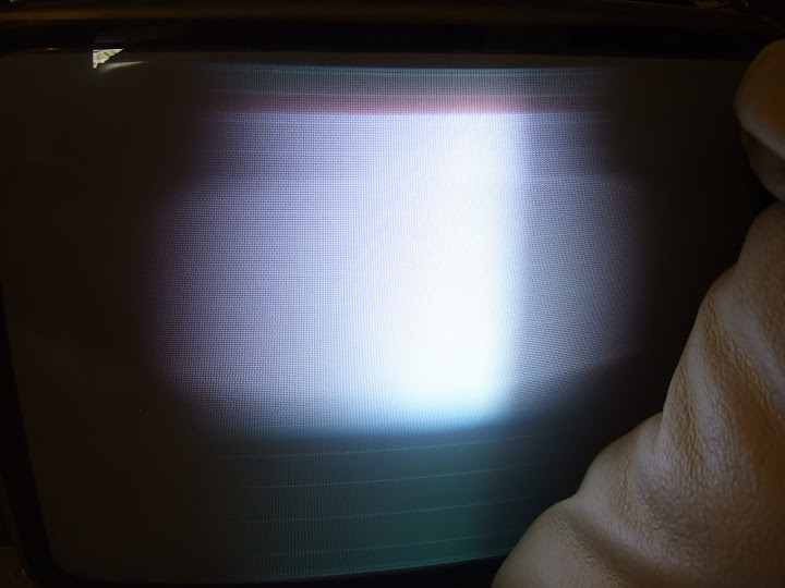

One a wonderful Toei monitor, 14 inch with a cm-r22 chassis, in a color space invaders cocktail. More pictures of the other to come soon.... That one has black instead of blue in the 60 in 1 back ground, but the blues are correct in the games, but the dark brown on DK is not there in DK 3.... really funky, plus I can't even tell what chassis that is.
I had a problem with this same monitor and got no help on here, but that could be because no one seems to like me, (BOO HOO) But i did find some info searching on my own, I would change the caps first and see what you get, hope this helps, C:\Users\ME\Desktop\MONITOR MANUALS\Toei MONITORS.mht
Not alot of info on Toei monitors out there. That's probably why you didn't get any help. I think I've only seen one once and that was years ago.
I have both chassis out. I need to rebuild the power supply in one space invaders, and the boards for both, so I figured I'll just suck it up and map out the board for a big bunch of caps....I honestly think it might be flyback, so I'm "arranging" to get a two monitors out of megatouches, and I'll keep these two as "back-up" if I can get them working. The down side is they are Toei, the upside is the tubes have zero burn...(actually the tubes are hitachi, the boards are Toei) Anyone ever try swapping a chassis out for a new Wei-ya or something? Just curious.
Well, first thing we'd need to know the resistance readings of the yoke's horizontal and vertical windings. Next is picture tube number. Then whether the Toei operates on 100 volts or 120 volts AC and if it uses an isolation transformer.
Once these factors are known, then a suitable Wei-ya replacement chassis can be chosen.
just a thanks to all, it's working great now....except for needing a horizontal width coil :) good thing I found an extra cocktail on the island for $20
