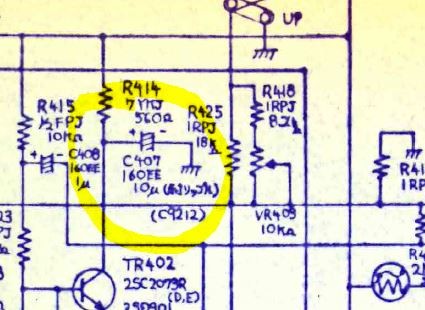

I'm recapping an older model Sanyo EZV (20") from an early TKG2 Donkey Kong. All of the caps on my chassis appear to be the original ones. The monitor chassis looked completely untouched.
C407 on my chassis is a 47uf 160V cap. Here is the cap:
The cap kit I bought lists C407 as a 10uf 250v cap.
I checked my (early version) schematics and there are two versions of the 20" EZV in the book.
The first says simply, "20-EZV" and the second says "20-EZV (R-B)" (meaning it's Revision B). Unfortunately, the "20 EZV" (Revision A) schematics are illegible in some spots. By comparing to the (much more legible) Revision B schematics I was able to locate the cap in question and I think this is it
Now here is the same cap on the 2nd Rev schematics
Obviously, the higher voltage between what's listed in the cap kits is not an issue (my cap kit lists C407 as a 10uf 250v cap and the Rev B schematics list it as 10uf 160v cap), but change from 47uf on Rev A to 10uf on Rev B. tripped me up.
Any opinions on whether I should keep a 47uf cap in there or will the 10uf be fine?

Rule of thumb for me is that if I'm capping an already working monitor, I always replace caps with the same uf values.
i would say obviously rev A didn't do what sanyo intended it to do so therefore you have rev B to fix rev A problems. put the 10uf 250v in.
BTW: most cap kits out there don't even account for the service bulletins that sanyo put out that affected cap value changes so sometimes you won't swap like for like cap values. as a rule of thumb if you don't know yes i recommend like for like swapping.

Substitute seems to be working. I'm not 100% done dialing in the monitor yet but seems like the substitute worked fine.
