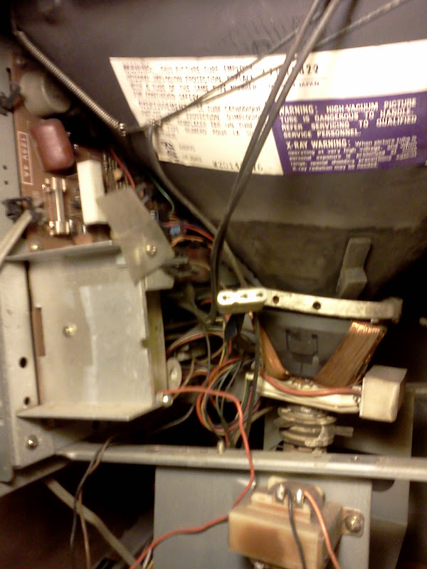

So I capped the audio amp board and...
While the sound is louder it still has a plucky banjo sound, and while now mario makes a sound when he jumps it is static.
Here is what I have done so far:
  • I bypassed the amp board completely and ran the sound from the game board directly to a set of amplified PC speakers and the sound is great.
  • I tried a different speaker connected to JD (amplified audio out) and it sounds just as bad.
  • I have replaced all the caps and the two transistors that are connected to heat sinks (all came from a Bob Roberts cap deluxe cap kit) and the sound is the same.
So the only things left to do are the following:
  • Check the voltage coming in on JC, anyone know what that should be?
  • Replace the remote volume pot on JB
  • Check the values on all the resistors (PITA)
  • Replace the diode (D37) on the board
  • Replace the other two transistors (TR371 & TR372) on the board.
  • Replace the ceramic disc cap (C379)
Anyone have a best guess where I should start?

Additionally a cable came unplugged and I need to know where to plug it back in. It is a black two lead wire that crosses over the corner of the blue warning label in this photo:
Can you tell me where it connects and what it is?
After you recap your audio amp check R383 on the sound amp.
Mine was bad. it had a crack in it and the side was blown out. it only let like half of the sounds to the speakers and had the plucky banjo sound like you have. after i replaced it i had clear sound again.
The black wire is possibly your degauss wire. see if it is hooked up.

So I will check that resistor tonight, anyone know what 1/2 NPJ means on the schematic? I am assuming I can just swap it for a standard 39Ω resistor??
The symbol doesn't look like a standard resistor symbol.
anyone know what 1/2 NPJ means on the schematic? The symbol doesn't look like a standard resistor symbol.
It's not a standard resistor. It's a fusible resistor. I.e. a resistor designed to fail open if too much current is drawn through it. The 1/2 means it's a half watt part.
Electrically, a standard resistor will work in it's place, it just won't be fusible any more. If you don't correct what blew the first one, you'll blow more stuff.

OK so that is on the power in to the amp board, so if it blew wouldn't it make the amp non-functional??? And damn! I guess I won't by buying that at Rat Shack today.
Thanks to Buffet and Ian, That Fusoresistoid was bad! Not to get a replacement! :mad: Damn Radio Shack I would have been able to buy this there back in '94 when I worked there! I can't believe I would place an order for one fusible resistor!
Ian, could I replace that with a standard 39Ω resistor and put a inline .5A on the wire (BK) coming in on connector JC? Wouldn't that be the same thing as a fusible resistor?
That looks pretty cooked. Have you figured out why it blew? It's just going to blow your new fuse if you don't. Check the various transistors on the board for shorts. Also, remember that the old part was 1/2 watt.
As for the inline fuse to use as a replacement, I think .5A should be fine, I don't know the exact current needed by the board, but I'd be surprised if it were more than that. I would probably use a slow blow fuse though, the fusible resistors are not usually fast acting.

Pretty sure this cap had something to do with it, I installed Bob's kit with came with replacements for the 2 transistors that have heat sinks. It didn't have the other two, but I assume that the ones in the kit are the ones that go bad.
I've found that fusible resistor blown.....a lot. It's almost always caused by bad caps.
