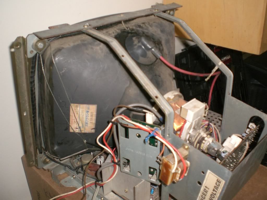

I am trying to identifly the monitor in my Donkey Kong Cabaret so I can order a cap kit. Here are some photos I took with it in the cabinet. Also I removed the audio amp board in the photos.
Amp:
Number on frame:
Looks like a Sanyo 20EZ chassis, but the frame looks a bit different. The audio board is definitely the same. What size monitor is this?

I am not sure, probably 14 inches? It is that cabaret that you saw.
Edit:
I was looking on Bob's site and it looks like it came in 19" and 13" I would say it is the 13"

OK, yeah, makes sense. I have never worked on a Nintendo cabaret before. Didn't know if that one had a full size monitor or not.

Thanks Ian! So we are 95% sure that this is a Sanyo EZ chassis? I am going to order the deluxe kit with the caps and transistors for the audio board too.

If that's out of your early model cabaret then it's probably what Nintendo called a 14-EZW. I've got schematics for it if you need them.
Yes it is serial #01572, will Bob Roberts EZ kit work with it?

I just did a cap kit on this very same 14" Sanyo monitor in my Nintendo mini, and I used Bob Roberts' 20 EZ cap kit with the audio board kit. Every cap matched up to my 14" chassis with the exception of one, which I tested and left in the chassis.

The cap that did not match from the 20" kit was C410. On the 20", it's a 100uf 160volt, but on the 14" model, C410 is a 47uf 160v.
Also, on the 20" model, C472 is a 100uf 160v. That cap doesn't exist on the 14", but on my 14", C462 is a 100uf 160v, so I changed it with that one.
I double checked the capacitance rating on the rest of the caps in the 20" kit, and I believe the rest of the caps matched up with what was already in my original chassis, so that should do it.
So you can get the 20" kit, and substitute one 47uf 160v cap for one of the 100uf 160v caps, and you should be good to go.
