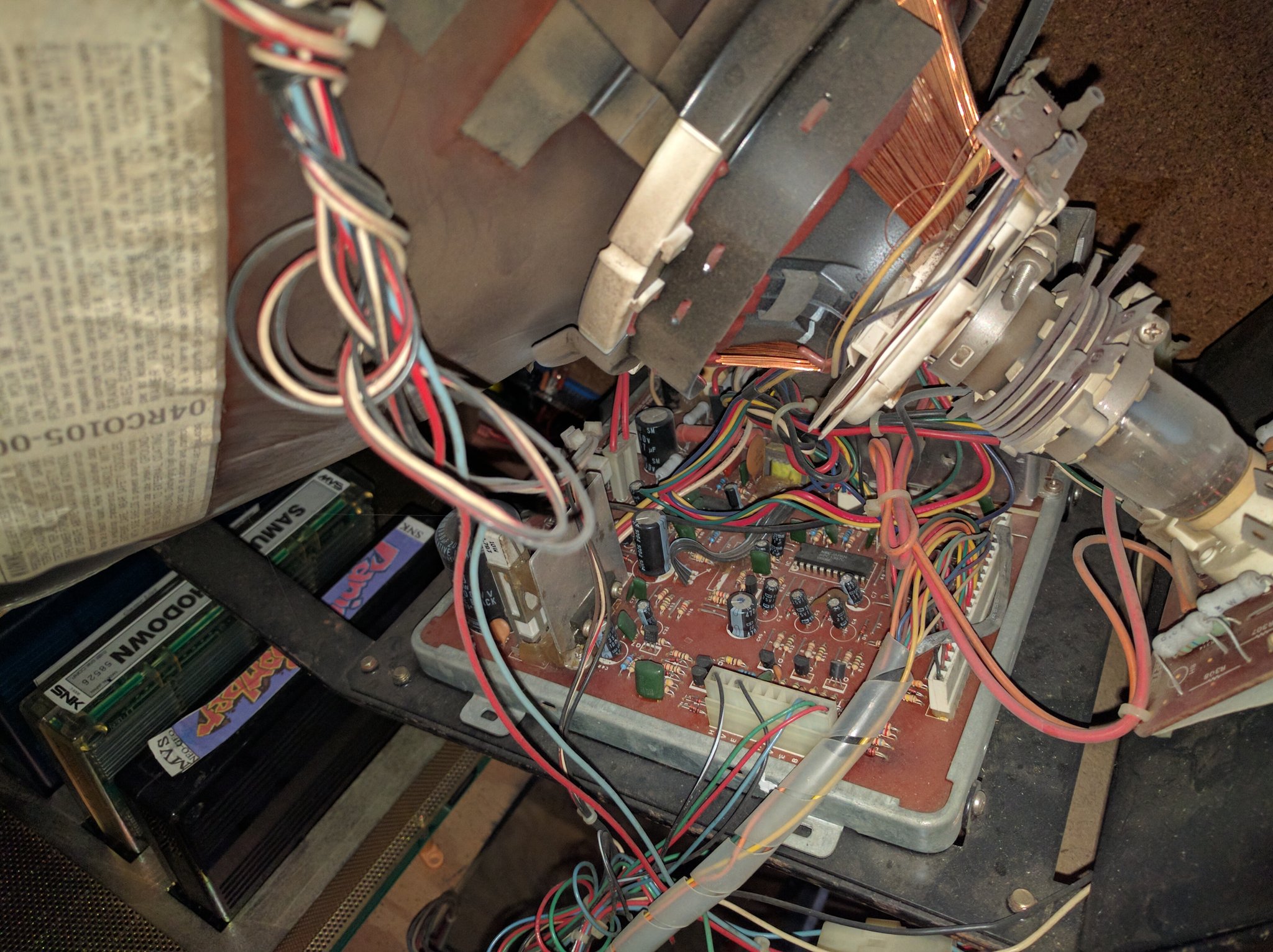

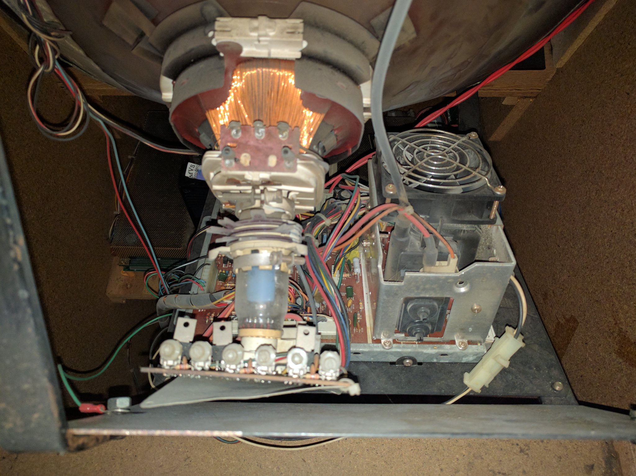

Is this a Hantarex MTC 9110???

I thought it was and ordered a flyback from Chad, but I had someone say it looked like a different chassis...
CxKDaMjWQAATbsi.jpg:large
CxKDb7FXEAAMMki.jpg:large
its a
Kortek KTW-N 26
k7000 clone almost only a couple caps different on the cap kit and locations and no flyback available for the kortek that i have ever seen.
Blargh. Does that mean the tube connector is compatible with a K7000 chassis?
from what i recall the yoke is not k7000 compatible and would have to be swapped. it should be a 10pin neck and i have a thread of Buffett's that i replied to and i gave him the yoke readings on that kortek. i haven't tried it but if you swap the yoke and have a 10pin k7000 it will work with the tube.
