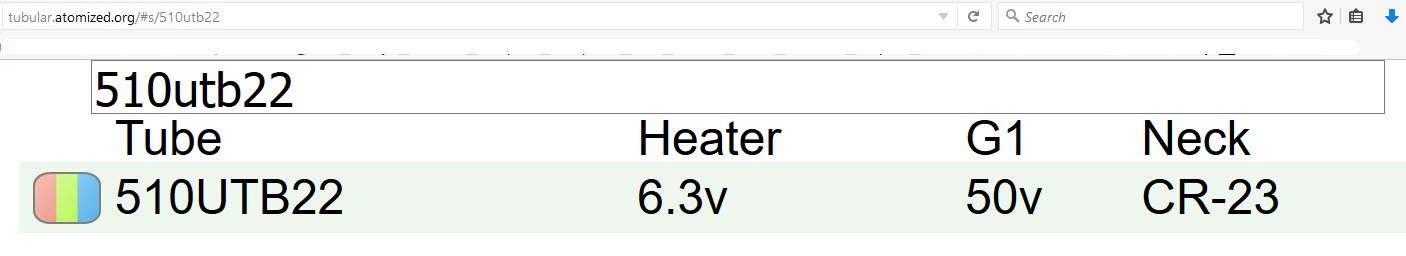

tron guy Super Moderator Staff member Donor 12 years: 2011, 2015-2025 VAPS Joined Jun 26, 2007 Messages 23,149 Reaction score 2,595 Location Eureka, California Feb 8, 2017 #1 I feel like I remember that it is, but this tube has no label/numbers on it. Edit Found some old notes I had saying that it is. Last edited: Feb 8, 2017
thegleek Well-known member Donor 11 years: 2015-2025 VAPS Joined Jan 23, 2015 Messages 17,267 Reaction score 7,983 Location Metro Detroit Area, Michigan Feb 8, 2017 #2 Sanyo 20EZ's tube should be 510UTB22 which is: CRT type reference from pg3: https://www.arcade-museum.com/manuals-monitors/sanyo-ezv19raster.pdf Also, check out the Arcade Monitor Reference section here: http://junknet.net/donor-tvs
Buffett Well-known member Donor 2012-2013 VAPS Joined Mar 12, 2010 Messages 10,991 Reaction score 263 Location Manassas va, Virginia Feb 9, 2017 #3 the simple answer is, yes they are a CR-23. Peace Buffett
