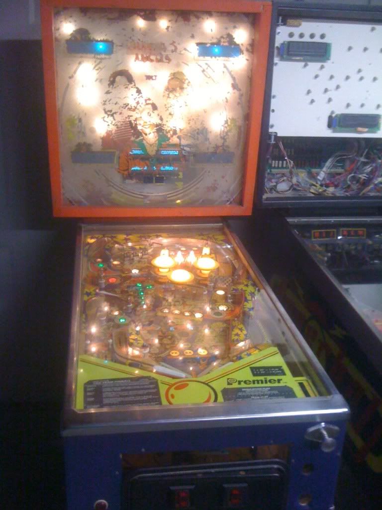

about 6 months ago i picked up a tag team pinball for 50$ it had been in a flood and due to it being made from crappy paper press board it had swollen to 2 inches in spots and was so soft in others you could shove your finger all the way thrue it with little effort
the machine also didnt fire up
the good thing was the playfeild was not affected by the water damage and was in really great shape allong with the back glass
after cleaning the edge connectors i was able to get the machine to fire right up and work flawless
fast foward to a month ago
thanks to splats i was able to get a old gottlieb cleopatra body for 10$ nothing left but wood but the tag team playfield fit right into it
about 2 weeks ago splats brought me a head from a charlies angles the back glass was shot but the head fit the cleo body perfect and the tag team back box fits into it just right
soo last night i riped everything out of the tag team and transferd it ll into its ne body donor and it all went smooth and without a hitch
stil need to figure out how i need to modfiy the head to fit the tag team glass (tag team glass has the metal strip at the bottom so it wont flush mount like the glass thats in the head) ,and paint the head to match the paint i did on the body
opps oh yea and i need a diffrent coin door since the one from the tag team was to small lol
looks great
so, right now you're saying it's a
CHARLIES ANGELS + TAG TEAM =
CHARLIES TAG TEAM ANGELS
or
CHARLIES TEAM
or a
ANGEL TEAM CHARLIE
or
TEAM ANGELS
hehe
might have a coin door you can have, maybe

my old lady is keping me at her house tonnight but man do i wan tto head home and finish up the tag team
ps splatts trading my sea hunt tommorow to ray for a dolly parton do you have any bally driver boards
would a driver board out of a baby pac man work ?

could not pass up a dolly i have not seen it yet but i trust ray he says non working blown driver board
but has perfect glass and good but dirty playfeild
ill miss my sea hunt but its going to a good home
