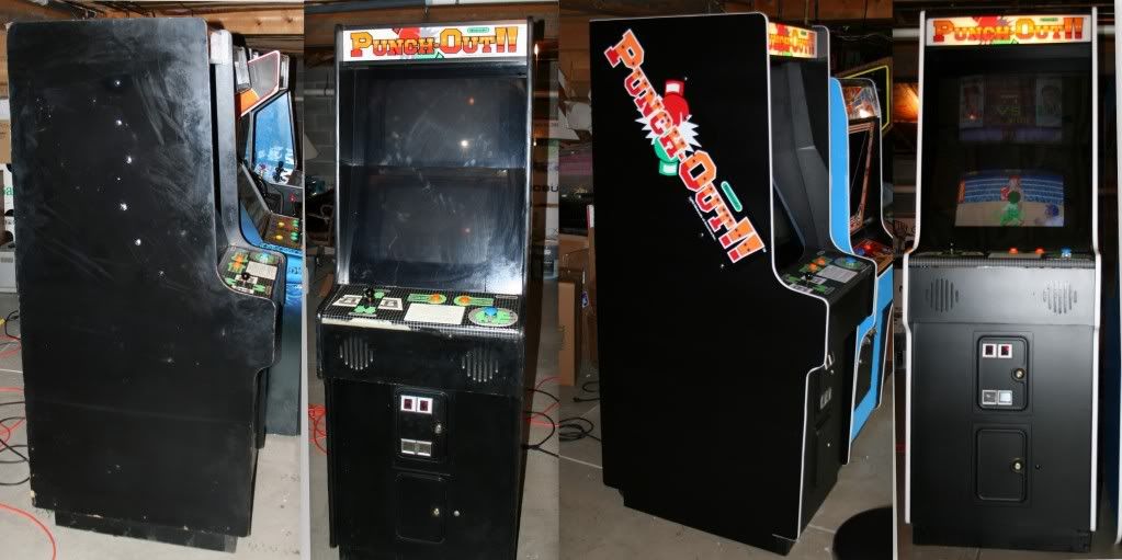

For those not familiar with some of my work,
Arkanoid II back to it's original Pac-man
Arkanoid back to it's original Centipede
Gorf
Robotron before and after
Punch-Out!! before and after
