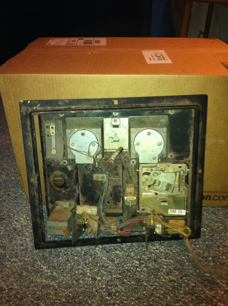

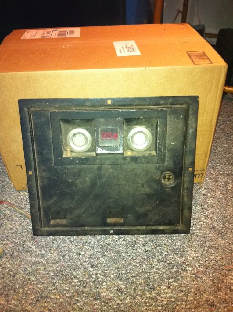

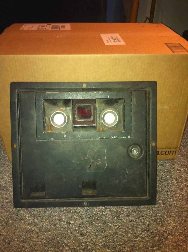

Well, I pulled out the second door and it's actually in nicer shape than the one I was going to restore however someone cut off the harness. So, now I'm thinking of restoring both doors but for my asteroids (without the owl eye door) I'll do a custom harness. At least that's the plans right now.
Found the plugs at Bob Roberts site.
Complete door (pretty dirty)
Clean door minute harness
