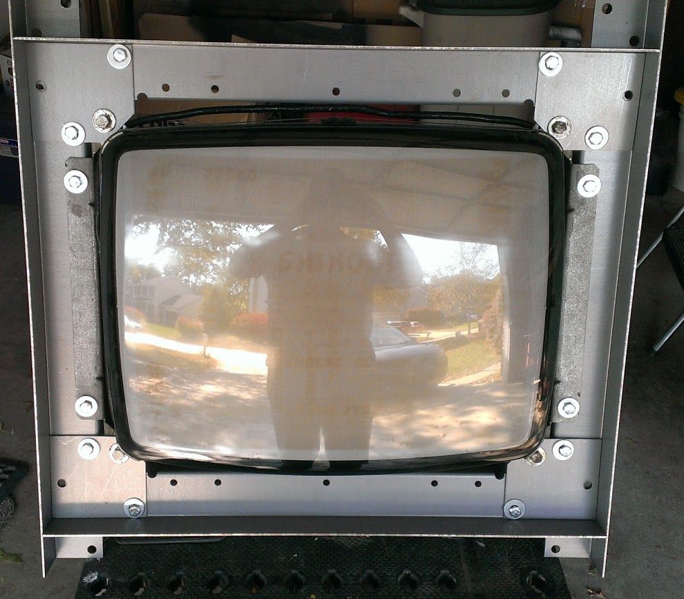

Monitor mounting brackets I installed from joseph77.(Much better than the other style)

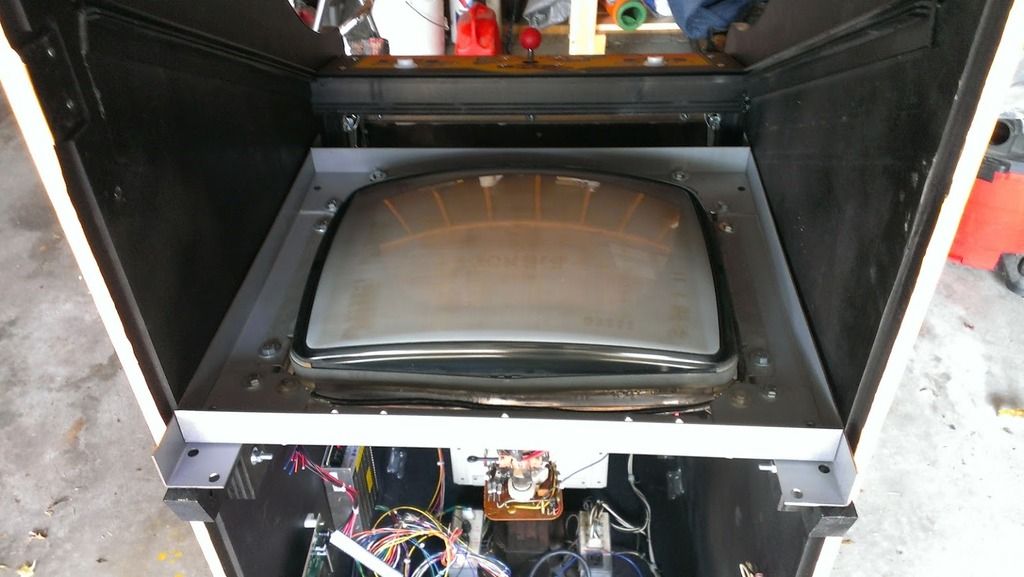

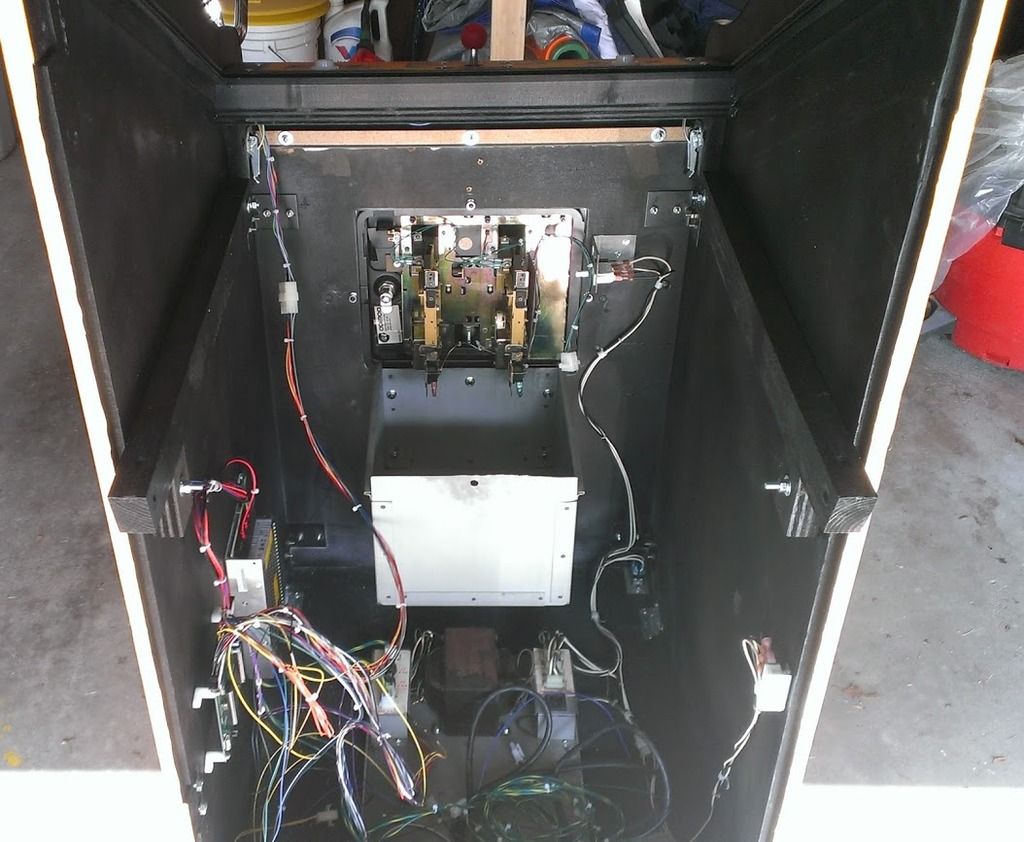

Cabinet with the side rails down.
Monitor ready to installed, just pushed up the side rails and installed the carriage bolts

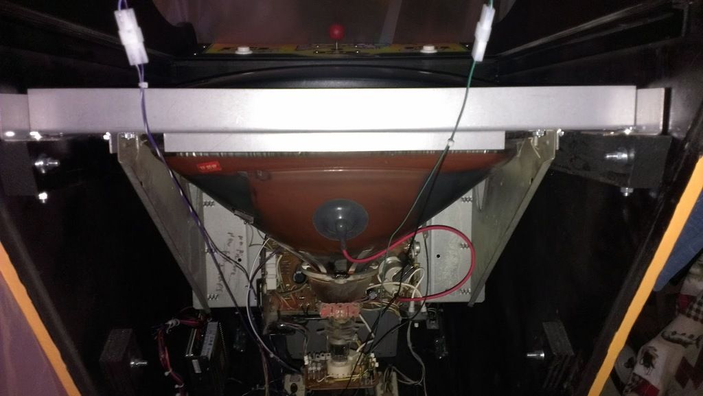

Installed from the back

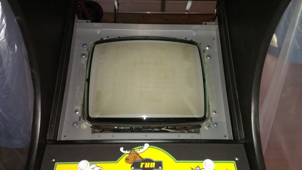

Installed from the front(love the burnin)
