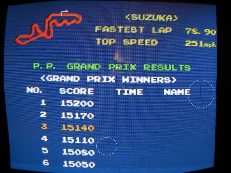

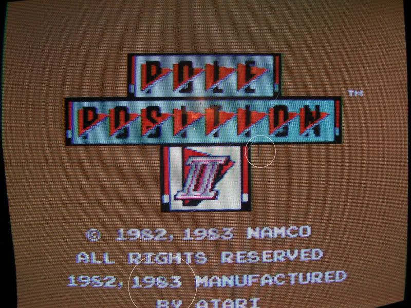

I've got this very very minor glitch with my Pole Position 2 board. Basically, a couple of the static screens (see below) have strange little one pixel wide black "strings". They're not on screen during actual gameplay... only primarily on the brown/tan titlescreen and the high score screen. When entering a high score, the little "strings" will sometimes dance around moving around the screen. Again... they don't affect gameplay one iota, but it would be cool to determine whats causing them and if they can be fixed.
Here are some photos (i've circled some of the problem areas):
Venturing a guess, you've got a poor connection with a video ROM? Maybe one leg is spotty. Just pure speculation, but that is kind of a wierd problem.

Frizz, watch them more closely. They are the attract mode sprites moving behind the title screen. You'll see the race car coming around the racetrack in attract mode is the dancing string in the center. The other one on the right is also a moving car as I recall. All 3 of my Pole II board sets had this same phenomenon.

That makes sense, I just watched it closely and your right.
But what about the moving "squiggly" lines during high score entry? The lines move around in a set pattern as I turn the wheel?
It is the same thing. It seems the attract mode runs constantly in the background of all screens other than the game screen.
Same deal, I couldn't figure out when that was happening by your pic but I just played a game and it has the same thing when its playing the music waiting for a initials input while turning the wheel.

Welp, I had a chance to go check out the game during lunch break... sure enough, I see exactly what you guys mean about the lines being the attract mode bleeding though somehow. Strange...
