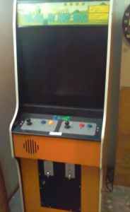

info on a super maro bros. im going to pickup tommorow
going to pick this up tommorow
damn ninty's guess since i have a mario i should get tis as well (next hng i know ill have all the dk's as well lol)
does this look like its going to be the vs version or the pc 10 version (i know kinda hard without a screen pic)
and what version is better and how can i tell
also if its the vs version am i able to run other vs games in this as well and if so is it just a matter of swaping out cards or do i have to change roms on the board set
That's a Nintendo Vs. Super Mario Bros. Was originally a DK JR. The VS. SMB is better than the PC-10 version cause it's not the NES version. It's unique. Good stuff.
You can change out the Nintendo Vs. games by changing the ROMs and PPUs or some games come on a daughter card. It's best to get a bunch of full PCBs and switch them out. Mark Spaeth also makes a switcher that will allow you to install two Vs. games on one PCB and switch between them.
