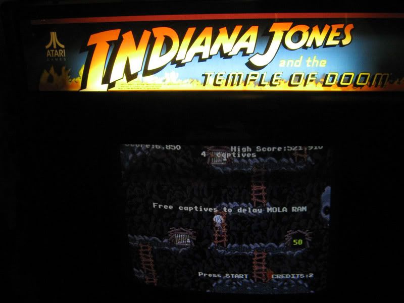

A rebuilt G07 chassis later (thanks Chris!) and Indy is up and running!
I need to adjust the stick a bit as I can't get diagonals to the top left and bottom left... but other than that she's working great. The sound on this game is pretty damn kickass. Thus far I've managed to get to 3rd place on the factory-default scoreboard.
I'm not sure if we're going to go full restore or half-ass it with black sides. It's hard to justify spending 150% of what you paid for the game for pretty generic side art.
