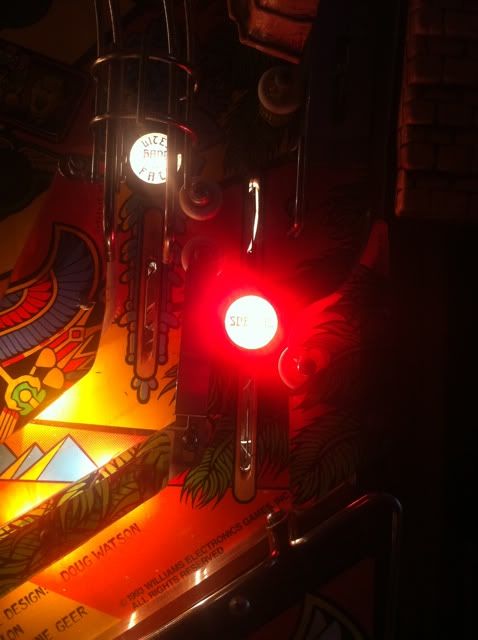

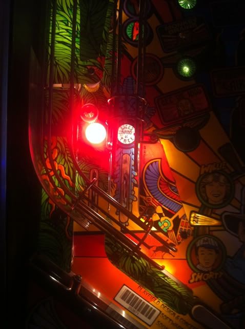

So during the middle of game yesterday, the 'special' lights on both outlanes spontaneously turn on. I didn't make any shots to light 'special' and nothing happens (and nothing should happen) by rolling over them, but they won't turn off. The only way I can get them to turn off is by opening the coin door, which releases the button in there rendering the flippers useless. Any idea why these lights may have just suddenly come on and what to do to get them to turn off?

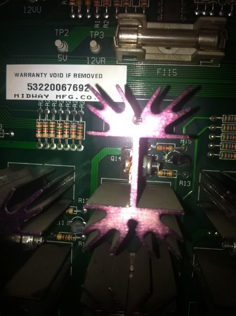

remove and replace Q14 and see if that fixes it.
might even change out Q13 too (2N5401) while i was in there

wouldnt keep the game on for very long until it is fixed as that whole circuit is stressed out because the transistor is shorted on and could take out other components
Now before I go and start destroying things, is this large spiky black object Q14 and the small black object to right of it Q13? These are on the largest board in there.
the large black object is the heatsink, with Q14 tightly screwed to it with a white paste in there to help dissipate the heat away from the transistor
heatsinks come in all kinds of sizes and shapes. they all achieve the same goal of wicking heat away..... kinda like the radiator in your house is a huge giant heatsink
the nuclear reactor in Japan went out of control and melted because it lost it's heatsink, from the Tsunami
yes to Q13. its low power and doesn't need a heatsink
hopefully Q14 is your problem. if not, we hope Q13 is the problem. if not, the IC at U1 controlled by the computer could be toast. hopefully, nothings wrong with the CPU that controls the whole circuit

take that transistor out and put your mulitmeter on diode test and see if it's bad
try not to flex the board at all. treat it like your great-great-grandmothers ancient casserole dish and you should be fine
