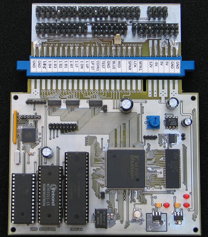

Can any of you guys that have the old Jrok adapters please take pictures of them and post them up? Man there is going to be a lot of gutted machines if we don't get some of these things made up fast.
Yes I have read the scat. If I or anyone else is going to make these we really need some pictures bad of all the different ones that were offered last round.
Try contacting James and see if he can help. If the demand is there he might be interested in doing another run of them?

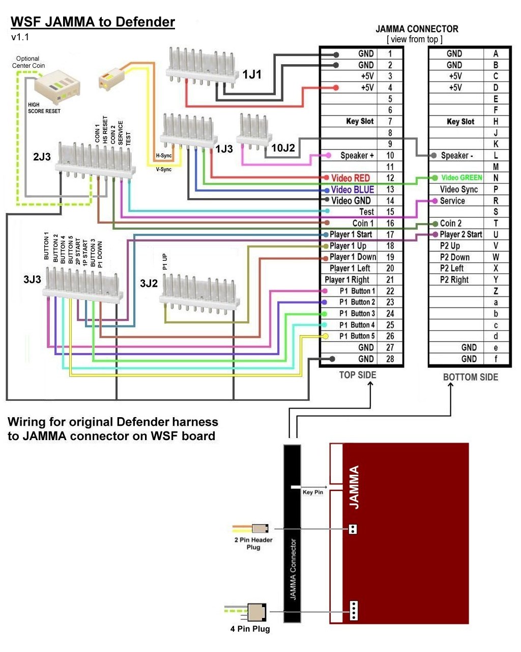

Base wiring
http://jrok.com/hardware/wsf/JAMMA/WSF_2_JAMMA_base_v11.jpg
Defender
http://jrok.com/hardware/wsf/JAMMA/defender_2_JAMMA_v11.jpg
Stargate
http://jrok.com/hardware/wsf/JAMMA/stargate_2_JAMMA_v11.jpg

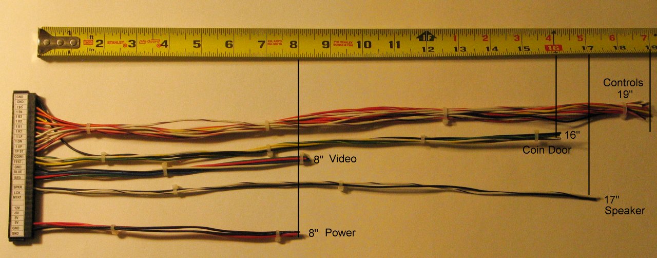

Lead lengths
http://jrok.com/hardware/wsf/JAMMA/JAMMA_defender_lead_lengths.jpg
Lead lengths work for other cabs, but my notes say to run the speaker wiring to 24" for the other cabs.

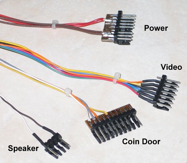

Power, video, coin door, speaker
http://jrok.com/hardware/wsf/JAMMA/JAMMA_2_WMS_cn1.jpg

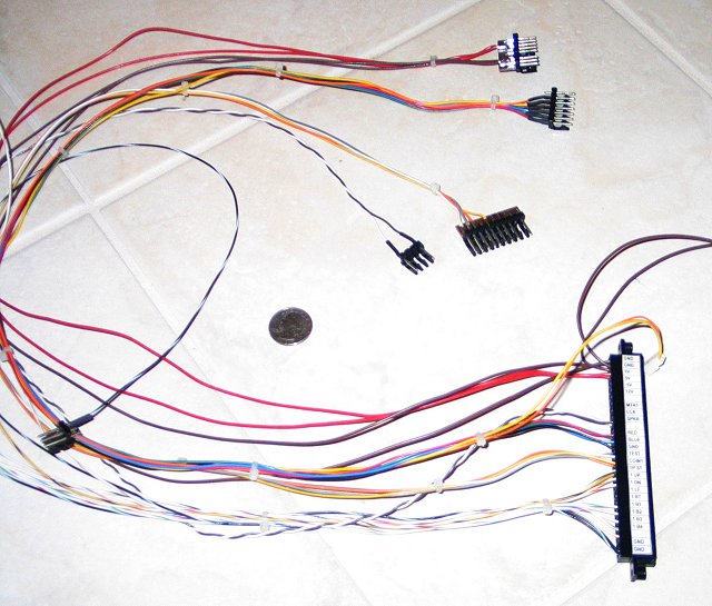

Messy early one top view
http://jrok.com/hardware/wsf/JAMMA_2_WMS_top.jpg
Controls are either wired specific to the game, like the second & third diagrams, or for a multigame-panel setup.
- James
Here Mike I fixed it for you...
If the demand is there I might be interested in doing run of them. :p
James has already said he has no intentions of producing the harnesses. Thanks for the diagrams. The harness picture with the ruler helped big time.

why not make a PCB Version with headers?
They won't fit to the connectors on a standard cab without cutting up the wiring harness. I tried this with Defender and it just would not fit nicely.
There just isn't enough slack on the stock harness to move the connectors around much.
EDIT: found the picture of it !
Worked great, except for the fact it didn't really fit.
- James

If you need more pictures, I have Defender, Stargate, and Sinistar harness adapters already.
