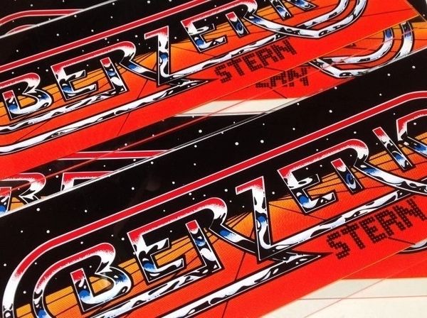

Looks FANTASTIC!! Where did you get the Batstick, marquee and bezel artwork from? I have an original cabinet, but it was converted to a Wonderboy (unfortunately). It has the original CRT, control panel and coin doors, which is cool. You can actually see Berserk burn-in so I know the CRT is original. I was thinking about putting original hardware in it, but it's a bit of a headache with those 5 boards. I have an ArcadeSD that has a good Berserk emulation, or I'm also looking out for a dedicated JROK at some point. They seem to be difficult to find.
Thanks! The Batstick along with everything else was just collected over years from different people selling. Luckily the marquee and glass bezel were still intact with the game, just needed a good cleaning.

Cool, thank you again. If I can't find a Batstick, is the Wico an acceptable alternative? I do have a Berzerk main board here, I bought it not realizing that I needed another 4 boards to make the game work!!! How's the speech implementation in the Arcade SD version? Is it fairly accurate? Where would I go to find a Berserk marquee and the bezel perimeter? My control panel still has the silkscreened artwork on it, but I haven't peeled up the rest of the Wonderboy artwork to see how it looks yet. Hopefully it's not too damaged and I can just put a light plexiglass over the original for protection. Thanks!
Yes, and if you can find a Wico with the skinny shaft one can argue that was original too since that's what Stern replaced the Batstick with in later builds.
ArcadeSD is emulation so it's good for what it is, JROK is technically identical being FPGA, but original, well it's original! so there's no debate and worth it if you take it on.
For the marquee, looks like Rich has 1 left and their quality is always good, they sometimes ship fast if in stock, may want to ask them about the bezel though, if not ask Joe from Szabo's arcade, he's good as well:
