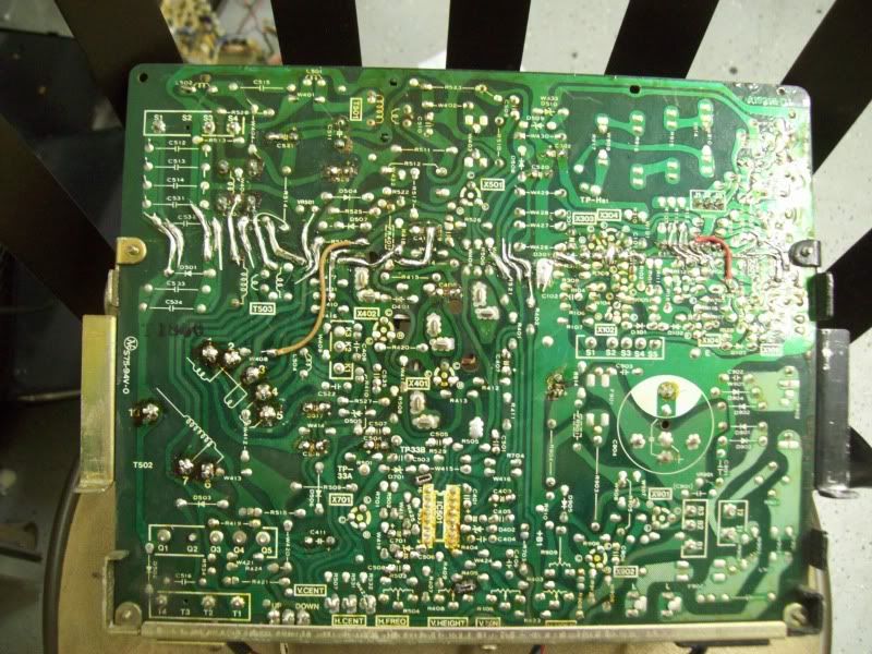

I normally don't mess with repairing these when they are badly cracked but it's friday, the old lady's gone and the beers are flowing nicely.
This chassis was busted in half lengthwise and needed some love. It has a newer flyback, newer width coil, a fresh set of caps and a rock solid sexy picture. It's been reinforced with cap legs all the way across and has plenty of strength so there should be no issues with installing it. If you have two complete non-working GO7's to trade, it's yours. It's not gorgeous on the bottom side but it works perfect. Send a pm if you wanna trade big boy!

CHRIS!!! WE MEANT PICS OF THE BOARD! THE MONITOR BOARD, FOR THE LOVE OF GOD ONLY SHOW PICTURES OF THE MONITOR BOARD!

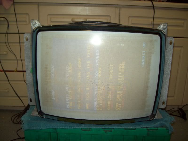

Here ya go, don't mind the horrific screenburn, this tube has thousands of hours on it as a test rig. This has already been spoken for btw.
Nice work! Really clean. I probably would have tried to save that one since the break looks clean on it, plus the board isn't charred up or anything. The most I've ever repaired was a neckboard broken clean in half, those aren't really that hard though.
These aren't real hard to fix but it does take a while and sometimes they won't work after all the effort. I've got another one here that belongs to a forum member that cracked all the way across but it took too many chunks out of the board and it really isn't worth fixing.
