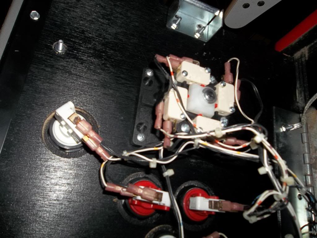

I was not able to make it to my other house today to check the IL sticks. I'll get there tomorrow since I need to get my plow working and that is where it is at.
Mike, did you ever figure out if they changed the nylon?
I forgot to post about this. Yes they still have the nylon. I took picks and forgot to post them. I was mixing them up with the Happ ones I installed at the same time.

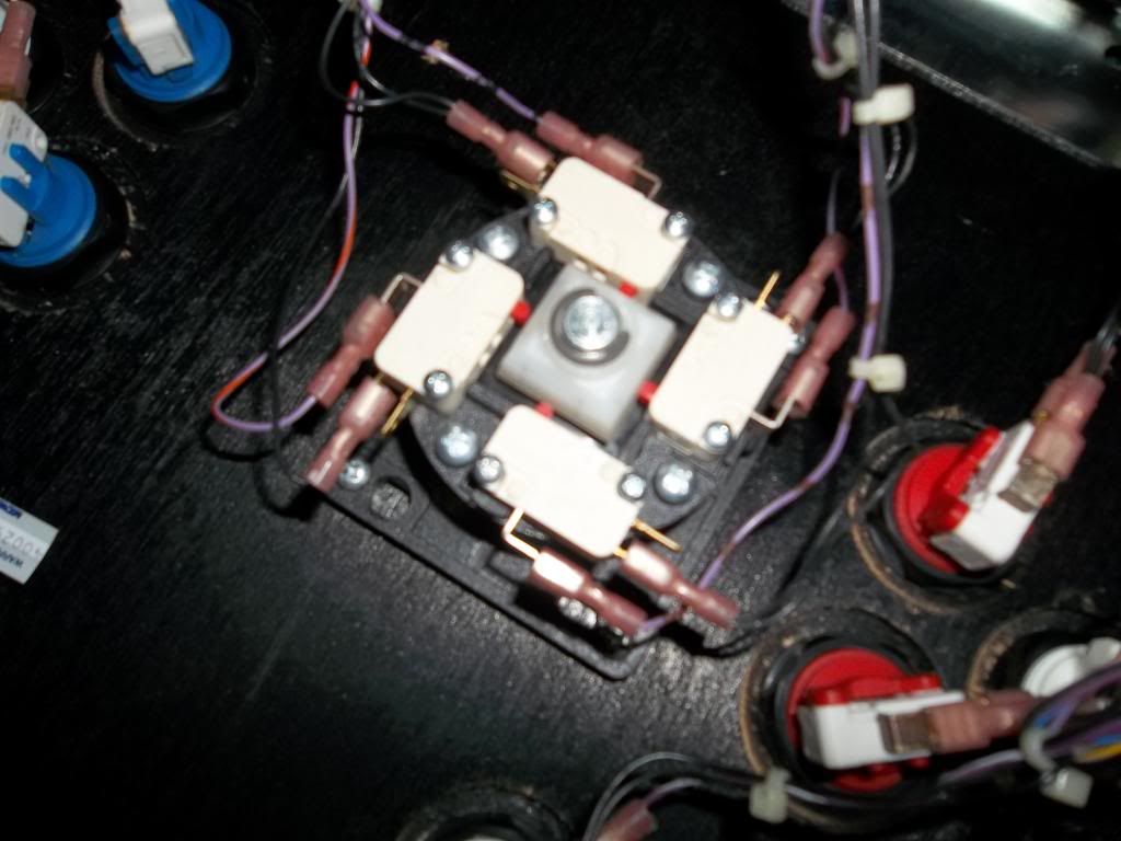

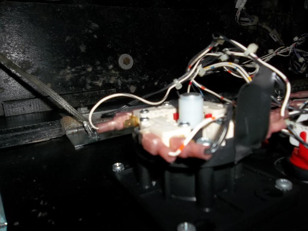

4 months later, I've finally gotten around to changing the joysticks on my KI. wasn't terribly fond of Paradise packing the sticks fully assembled, but whatever.
if any part was black on the Comps, they're not on the Euros. :) I haven't turned the game on, cause I don't wanna wake the dead with the power on BONG!!!! sound, but I can already feel a significant difference. FWIW, when I bought the blue Comps for my KI initially, I swapped over the white actuators from the joysticks the cab had originally had because the black Comps would stick and rotate with the shaft and bind up. they were like this for a long time until I did the stiff spring replacement, which turned out to be a major mistake. for whatever reason, the actuators were shaped differently, they just had straight edges, they didn't have that second angle like the Euro/Comp design.
I think I was able to finally track down the white ones again, they might be in my MK cab now which does actually have the stiff springs still (works great for MK for some reason)
