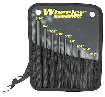

Now you see the large metal pin sticking out of the pivot ball. Remove that first. The best thing to use is a pin remover from a set.
But if you don't have that, this pin can be removed with a hammer and a bolt.
That will get it part way out. Then I use a nail or broken bit that will fit in the hole and punch it the rest of the way out.
