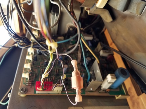

Identify WG montor
LovelyCoCoNuts
Dec 10, 2016
3,035
110
Texas
It's a k7000 series... But which? Neck board saays p5355? I cant find anything on klov or arcadecup...

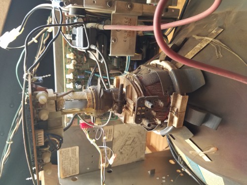

It doesn't really matter the exact model... Unless it's a medium res 19" (which it isn't), or a zenith k7000a (which it also isn't).

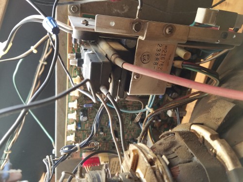

Can you get a better picture of the chassis. There is either a P447 or P538 on the main chassis board. That will determine if it is 19" or 25" chassis.
However from one picture it appears the width coil is white. If it is then it should be a 25" chassis.
Tube is 19", heat sink for vertical IC is short, neckboard is for minineck. Everything points to 19".
19" swapped into a millipede.
I was unsure if its like those k7203/k7302 i am yrading off that needed a seperate or special kit.
This is for a buddy of mine else I would have better pics.
Thank you for the responses.
