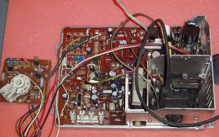

Identify my monitor?
Looks like a Kortek KTX26 with optional remote board...
That's it!
Know where I can get a replacement adjustment board? The one I have I can't quite nail down H and V hold.
Have you fiddled with those slide switches? they're for changing the sync polarity, so they might be in the wrong position, assuming you have the sync hooked up properly...
Everything seems to be hooked up properly. What position should the switches be in?
The v-hold and h-hold are super sensitive.
Have you capped it yet? I'm not sure which position they should be in. Try moving one only. If it doesn't help, move it back and try the other. If neither help by itself, try moving both...
Haven't capped it yet. It may be the board I am trying to use. I have a 48-in-1 laying around. Do you know if this board requires different wiring for Sync than the standard Jamma setup? Looking at the manual for the 48-in-1... it doesn't seem like it.
