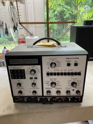

The Sencore CM2125 can be had cheap on ebay it is the big brother to the CM2000 and a better tool. This is how I have mine set up. I use a break out box so I can use separate test leads.
The nice thing about these is the built in isolated meter and drive substitution systems. It is also programmable so you can save presets. It is a very useful tool that is often overlooked because the adapters are always missing and you have to make your own. Here is the manual

I really like your breakout box design and am tempted to make my own now (reduce the number of cables I need to keep). I have to ask though, what is TVA power and how often do you use it?
Regarding "best" setup, it really is whatever works best for you. I have a CM2000 and love it to death. In terms of power, I have a box with an iso and pacman transformer for my AC needs. For Nintendo monitors I have a seperate 100V iso box.
Sencore made a video analyzer (TVA92) that had some nice yoke and ringer tests but it had to be connected to a VG91 (unobtanium) to power up and get sync. I wired this switch in to power it up. I got rid of the TVA92 and got a HA2500 that handles the yoke and flyback tests and has a great substitution B+ power supply. This is my bench, I made an isolated variac AC/DC supply last weekend as the monitor I am working on needed 95VDC power.
