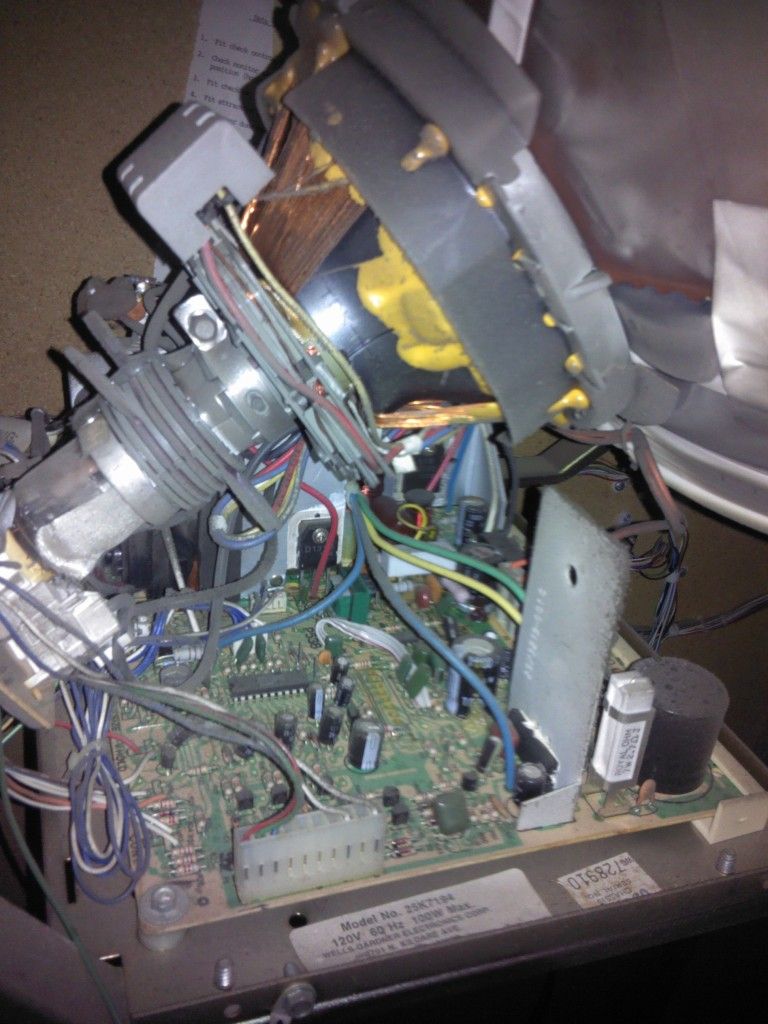

I have 2 monitors, each with curl at the top of the monitor. The picture on both monitors also "twitch" (doubt I'm using the correct term) sometimes. My speculation is cap kit, but I need a positive ID on both monitors and also want to be sure of some settings on the monitors.

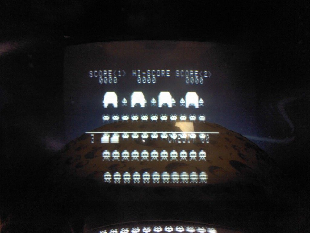

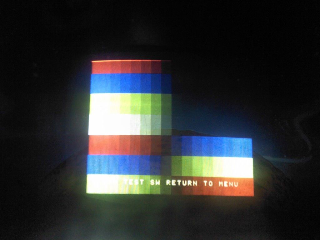

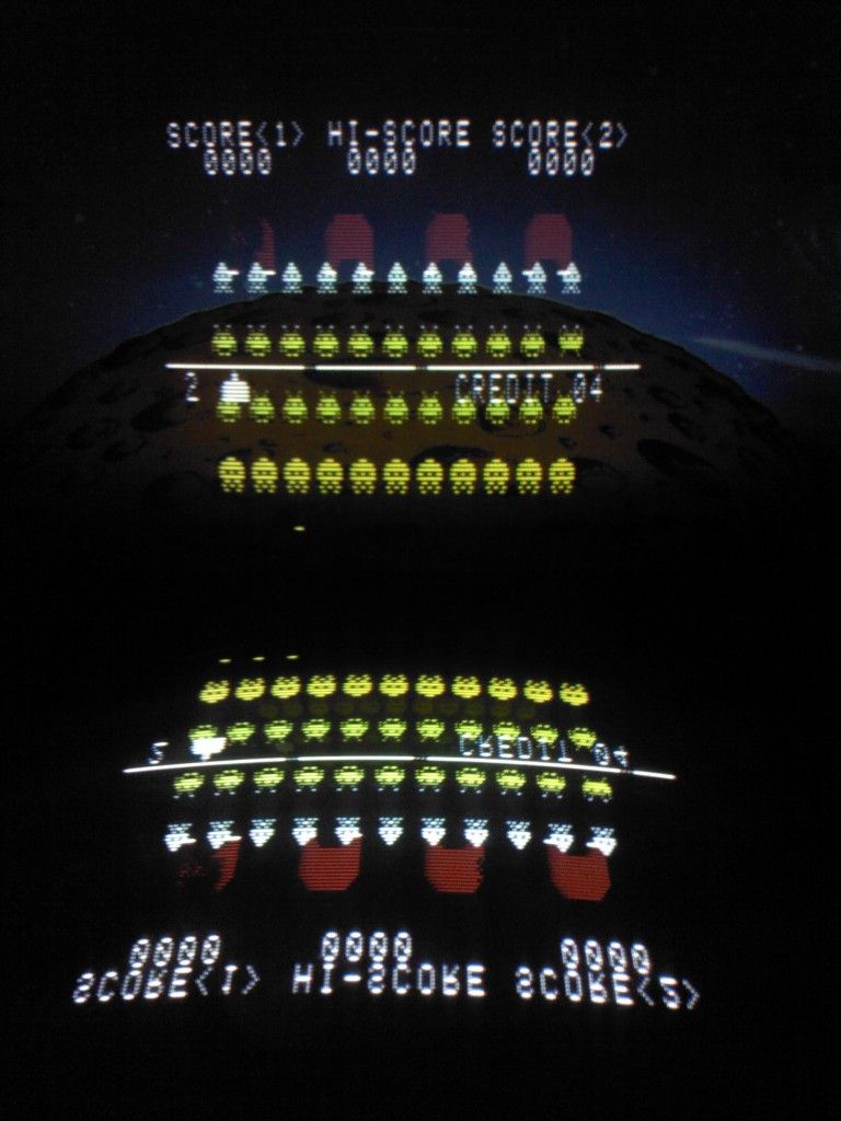

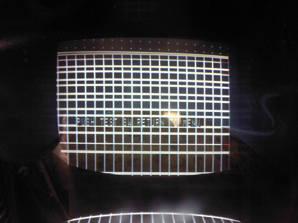

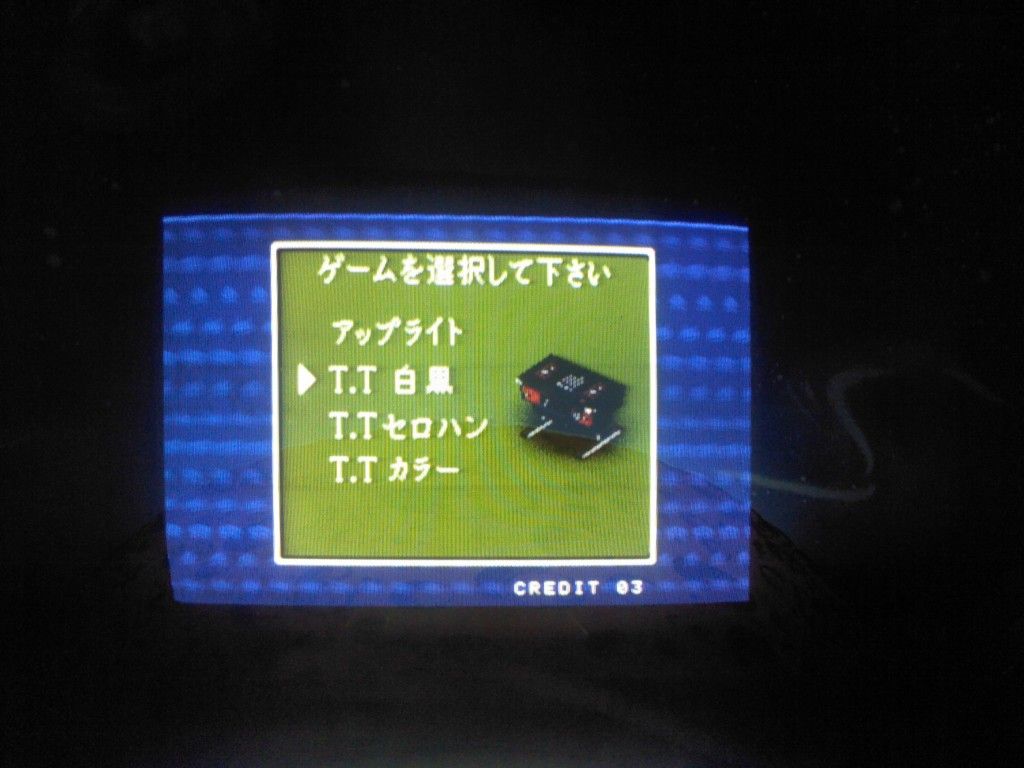

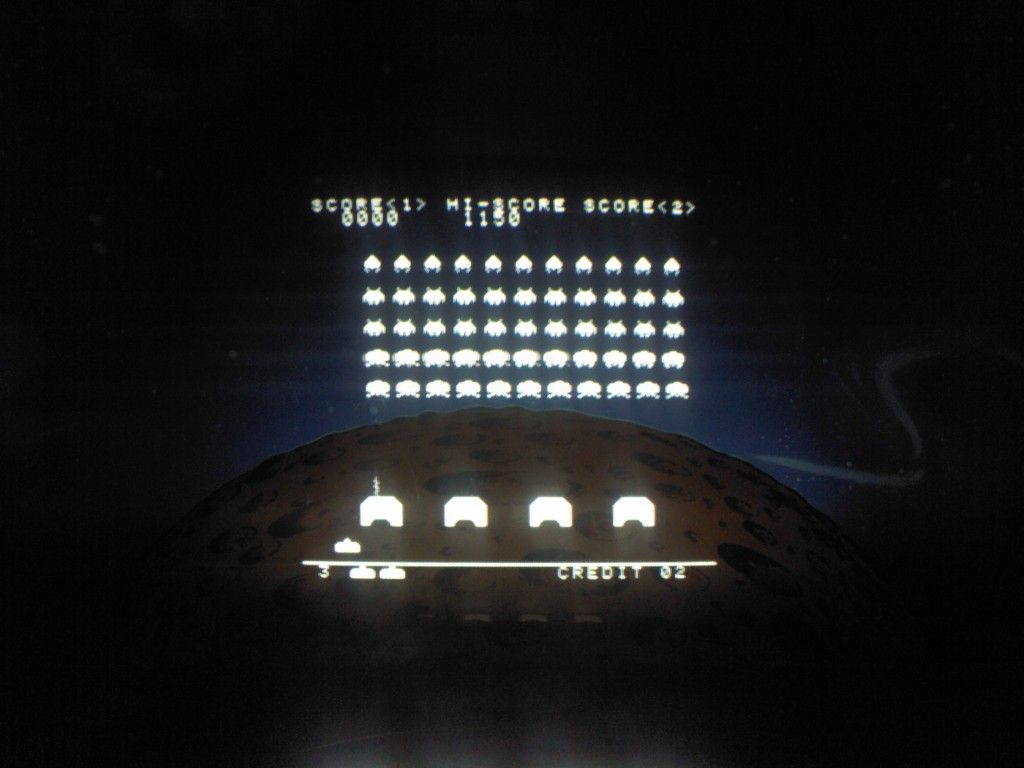

First up is my Space Invaders. The cab is a Midway's Space Invaders that has been upgraded with a color monitor and a Japanese Space Invaders DX. I read on another thread here that sometimes curl can be unavoidable if a newer board (DX was made in 1994) was used with an older monitor (although I have no clue what this monitor is). If that is the case and the curl isn't damaging anything then it is not the end of the world. However, if fixable I'd like to fix it.

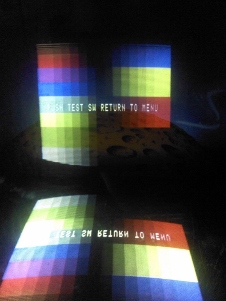

Anyways, here are pics of the curl in the menu and on the monitor test screen:

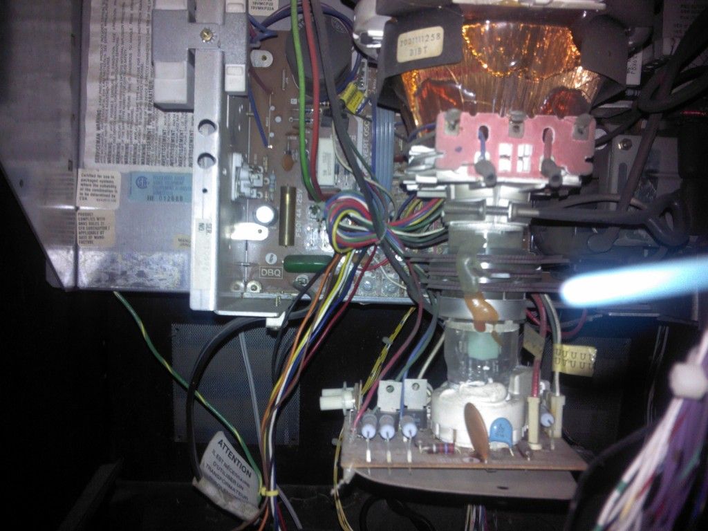

I cannot find definitive markings on the monitor chassis, however there is a sticker on the tube labeled WG45960. Here are some pics of the monitor. If more are needed for a positive ID, or if anyone knows where the model number would be listed please let me know.

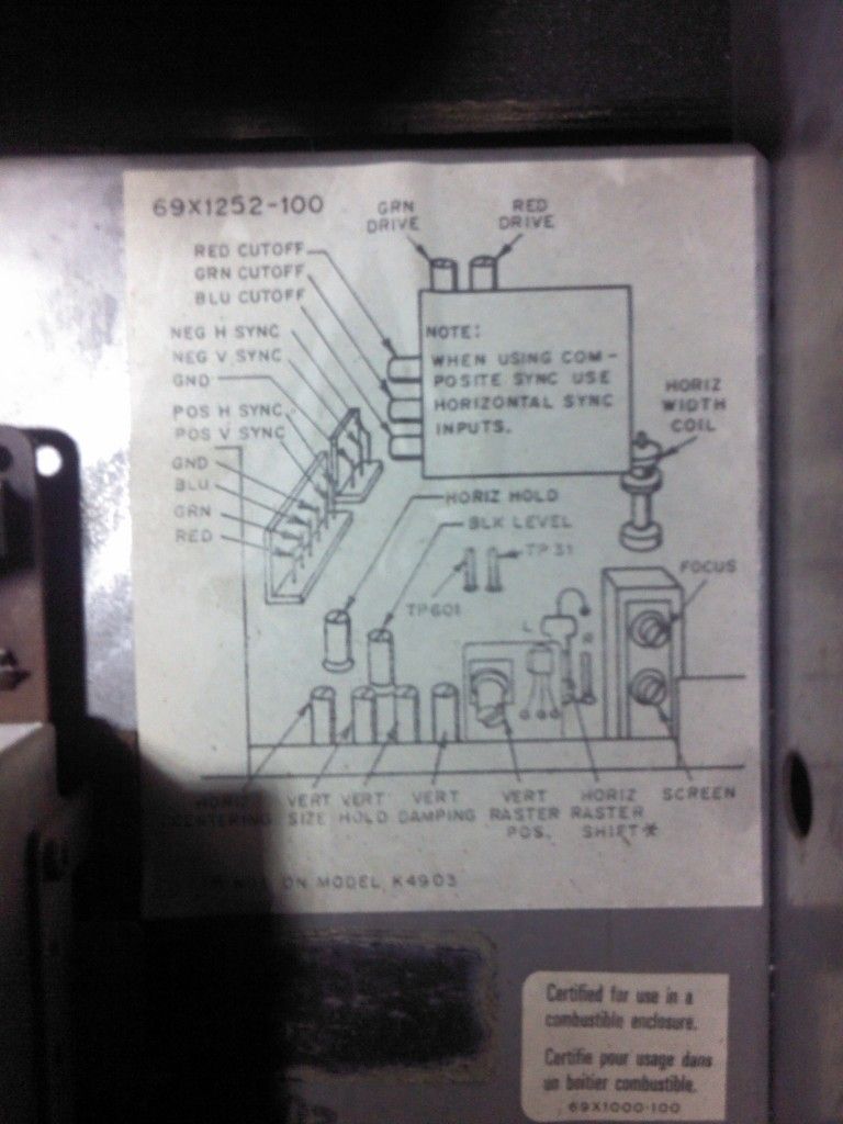

Here is a sticker next to the monitor that may help. Even if it doesn't, what exactly do vertical/horizontal raster and vertical/horizontal damping adjust?

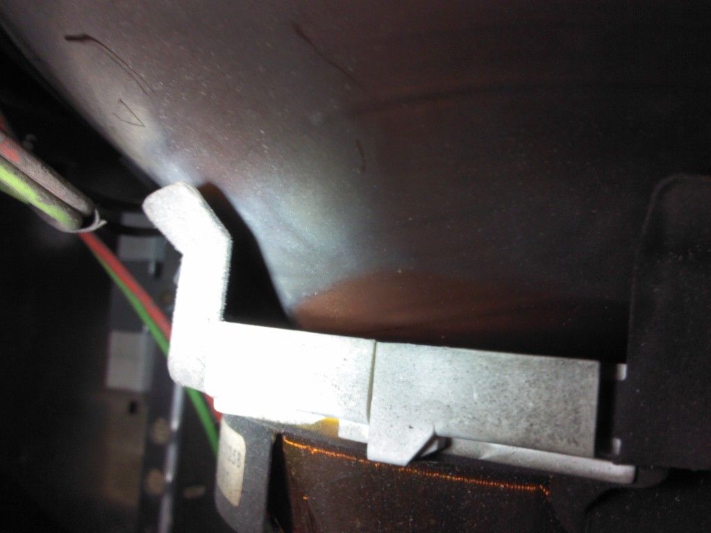

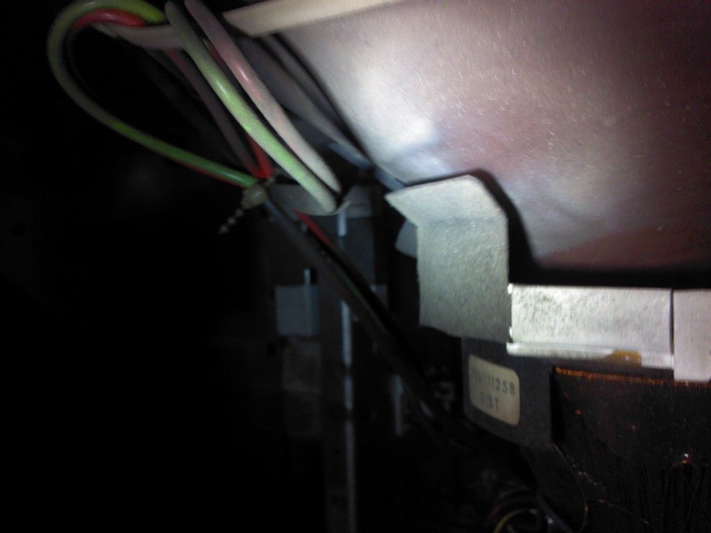

One more question on this monitor. On the yoke, there are these plastic pieces around the white plastic (look like spacers so the yoke doesn't go too far up the tube). There is space between those and the tube. Should the yoke be slid up, or would that not be the problem?

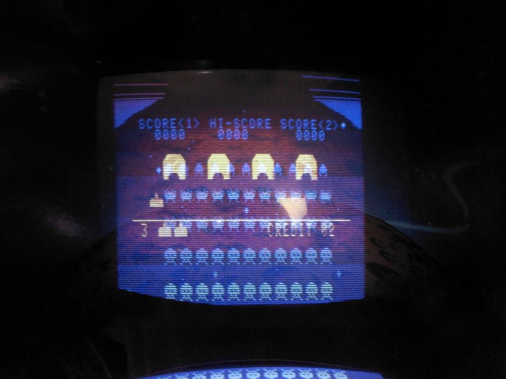

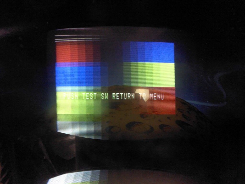

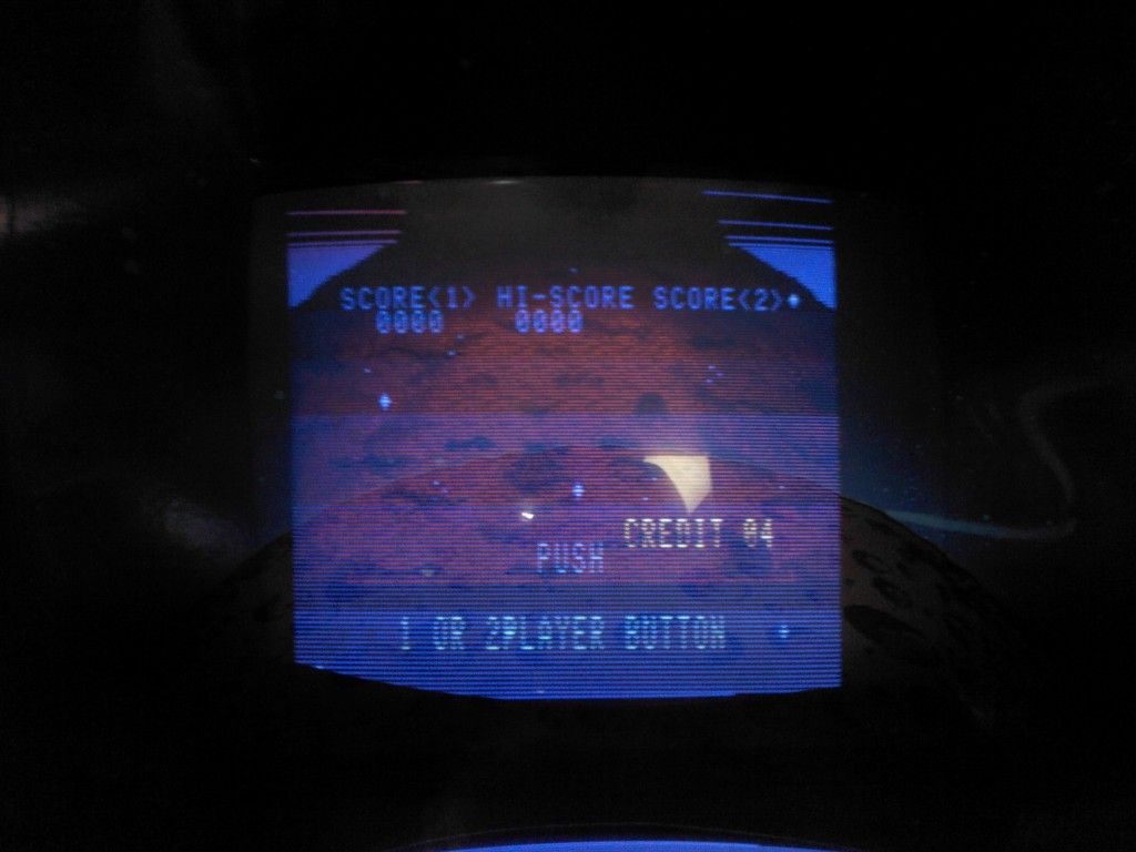

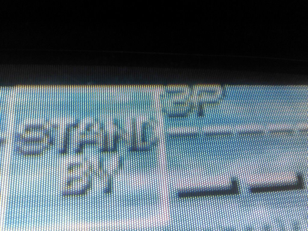

Next up, is the monitor in my Captain America and the Avengers. Similarly, this one also gets curl after being on for a few minutes and also twitches/shakes a little.

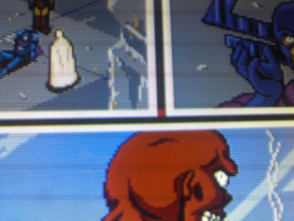

In this one, the whites bleed red a little also (visible in the black space between comic strips). Is this from the flyback being turned up too high?
Here is a pic of the curl.
Here is a pic of the monitor. Please help me ID this one also.

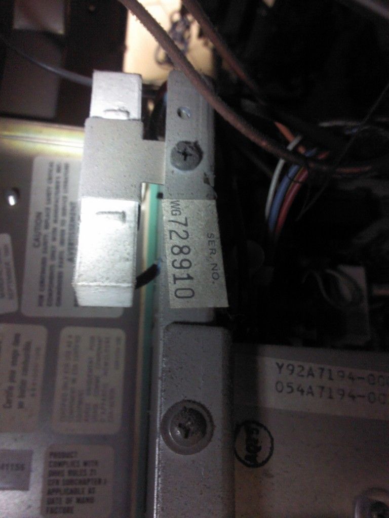

On this monitor, both the chassis and the tube have this sticker (WG728910).
Any and all help is greatly appreciated. If more pics are needed, I'll be happy to oblige.
top one is a WG 4900.
second is a WG K7000.
both suffer from failing caps allot.
replace the caps and readjust and you will be good.

Thank you very much for the quick reply! Does anyone know what the raster and damping dials affect (for when I'm adjusting after the cap replacement)?
turn them and watch the screen.
they control the linearity of the picture mostly.
its the width between the scan lines.
you will need to watch it for your self to see exactly what they do.
and adjust the pot till it looks the best to you.

On the first monitor you do not have curl, but vertical foldover. Simply reduce the V.size.
I'm finding it very difficult to see any "curling" on the second one.

Interesting. I will have to try adjusting the V.Size then. Would a cap kit still be needed to keep the picture from shaking?
It's much easier to see in person than in the photo (colors too similar in the photo), but the top of the box that says "Stand By" curls to the right a bit (not too bad though).
I do see what you mean now, hopefully you just need to make a slight adjustment to the h.hold.

Wow, a Linearity and fold over going on. Have you checked the pots to make sure they are the right value and actually working? Since you've done the caps the next thing would be the pre drive IC or some other discrete part. I know that doesn't really help narrow things down though.
I'd also tripple check to make sure that you put the right caps in the right places and that none are in backwards.
Next time I pull the chassis, I will check the caps again. I have not checked the pots, but they were in the chassis when the only problem was a shaking picture. I notice changes when each pot is turned, so they at least work to some extent. What are linearity and fold over caused by (in general at least)? Others said it could be a convergence issue..... could that be caused by the yoke not being up all the way? I reflowed all the solder on the neck board and the chassis. When soldering, I try not to keep the iron on the board too long but if the heat from my soldering iron took out a diode, might that cause this issue?
Convergence wouldn't cause problems like that. If you have a convergence problem you would have full deflection but the colors wouldn't be lined up.
Folder overs and linearity problems are usually caused by bad caps, you've already replaced them but because the pic is WORSE now I think a cap is in the wrong place or backwards. They can also be caused by bad deflection IC's and other discrete parts that have failed. I'd start with the caps though.
