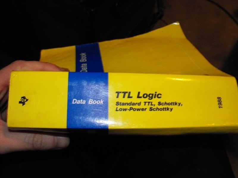

I used to have STACKS of printed data sheets laying around here (literally a stack about 3' tall total) until, thank God, I finally found my TI TTL data book... It takes a lot of digging and remembering stuff... but it's well worth it when you finally figure out that a few cents in a NAND gate is all you needed to get your board running again.
The ics that are showing high and low are pulsing so it good to hear that they are suppose to be showing high and low, thanks for that info one less thing to worry about. I will have to go through my ttl cook book again and do some back tracing like you said. Thanks for your help :)
What's this TTL Cook book tell you? [Details of the book]
Depending on when it's made (mines a little old, but new enough), it'll have the details and operations of pretty much every major chip you would run across on an old arcade board.
Just nice to have on hand to keep you from having to look up datasheets for every chip online. REALLY handy when you're out "in the field".
