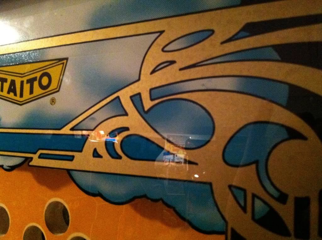

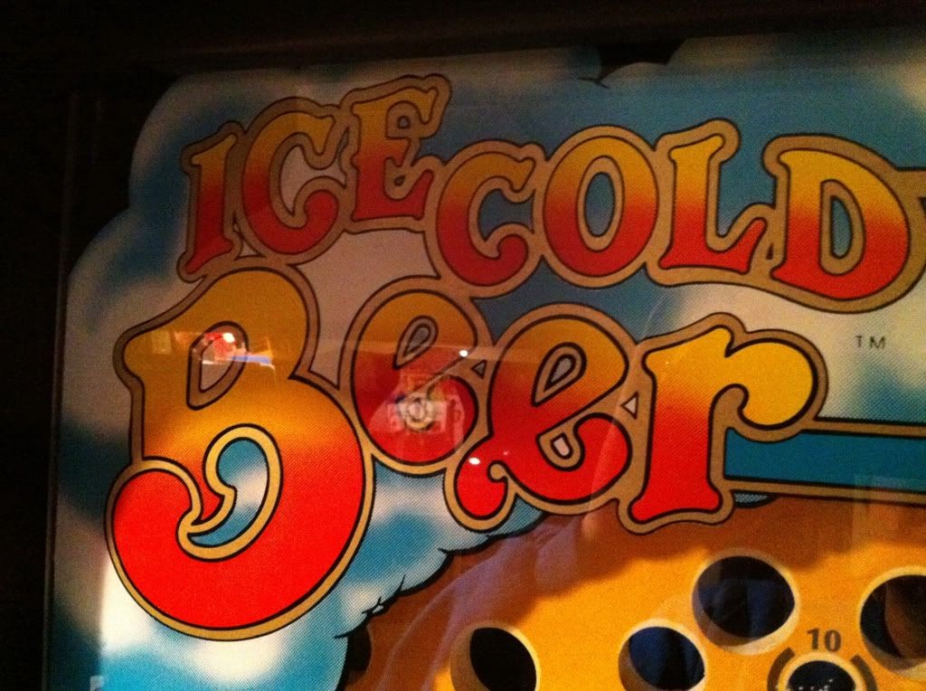

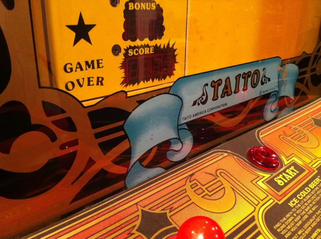

I really would love to do it but I really think it would be a major undertaking. In order to do it right you really need have it screened on glass and I'm pretty sure the gold ink is gold leaf. Either way, from my discussions with Rich this is a $200+ / Per back glass to make this happen and most likely closer to $300.00.

Lots of gold. I'm sure you "could" you metallic gold ink (yellow ink is a really bad idea seeing there is already yellow in the art). Just not sure how close it would be but I'm sure this could be an option. Still a pretty pricy project and from what I'm seeing as far as similar reproduction pinball projects this would be pretty expensive.

Say, is the gold mirrored or flat like the new LOTR LE backglasses?
So it iis a "mirror gold"?
yeah agree with Bill if thats the case, a mettatic gold could be screened in place of it

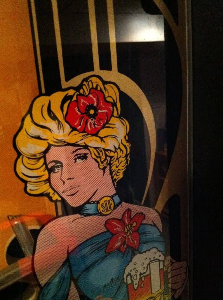

Wait until you see the halftone clouds in the art. Whoever screens them really needs an original in their possession to refer too.
Ya, I saw your pics but I'm sure I can successfully reproduce the halftones.

Not saying it can't be done (wasn't trying to sound like a Naysayer)... Just going to be a challenge to make those halftones look right. You can most likely use a "metallic" gold.
I'd love to see this happen. Would be very beneficial if you can gain access to an original glass so you can scan those halftones in at 600 DPI and maybe you could use some vector with some raster in order to keep the halftones close to the original.
