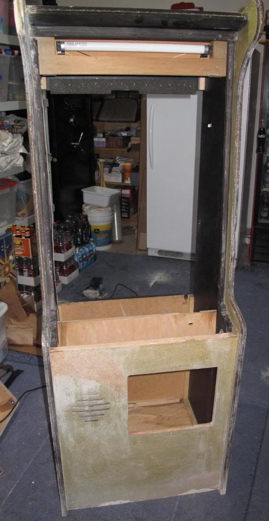

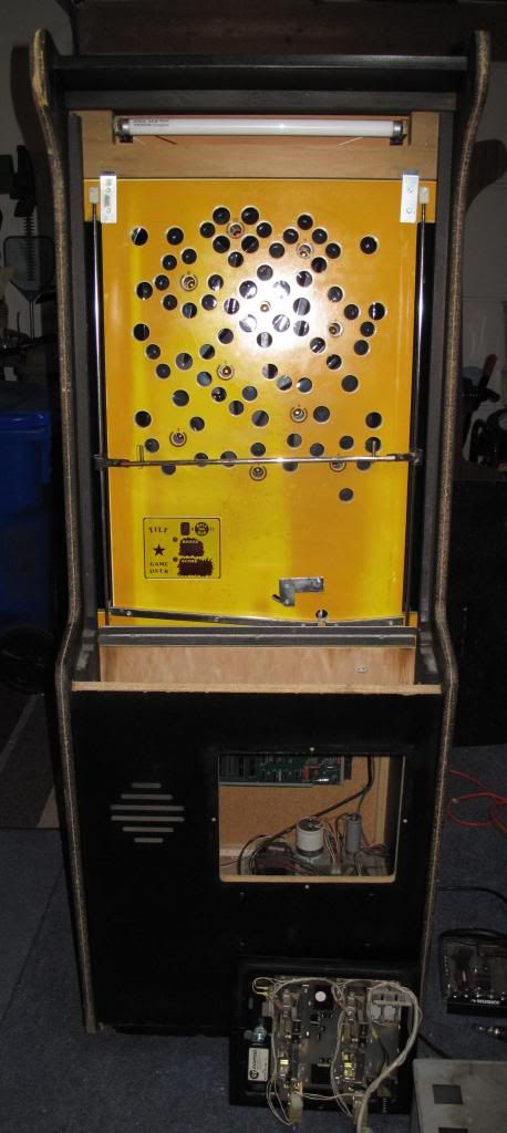

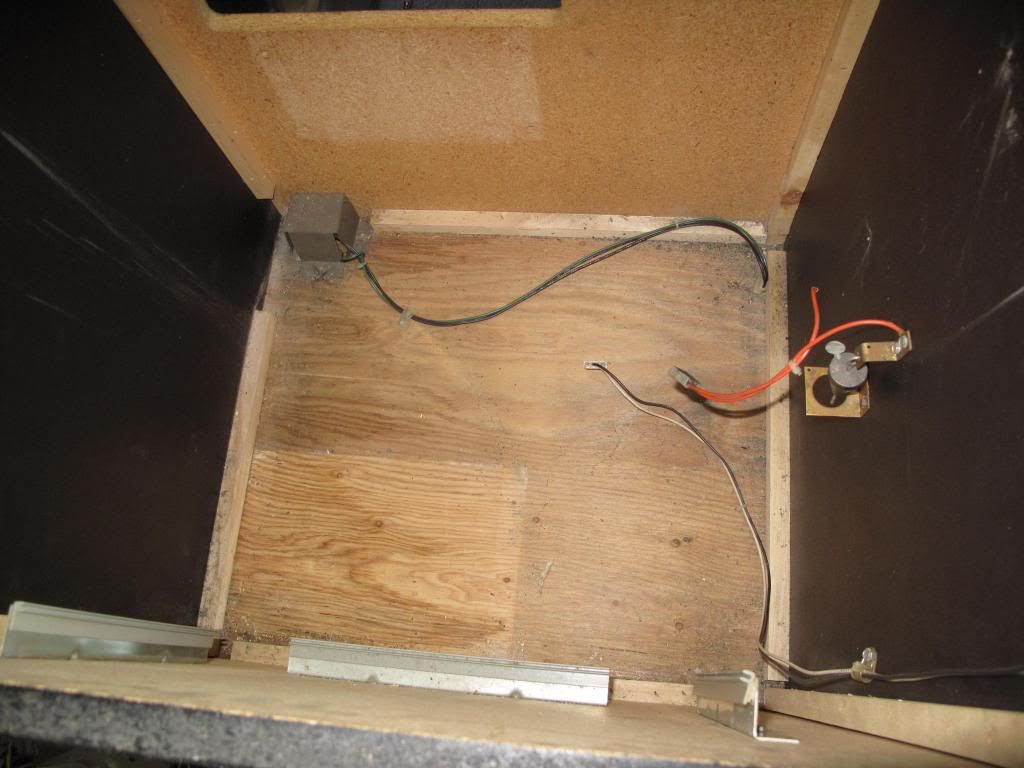

Here's contestant #1, her before shots:
It is hard to tell in these shots, but the upper left of the cabinet has some damage, particularly on the inside just above the playfield. I will have to build that back up with bondo.

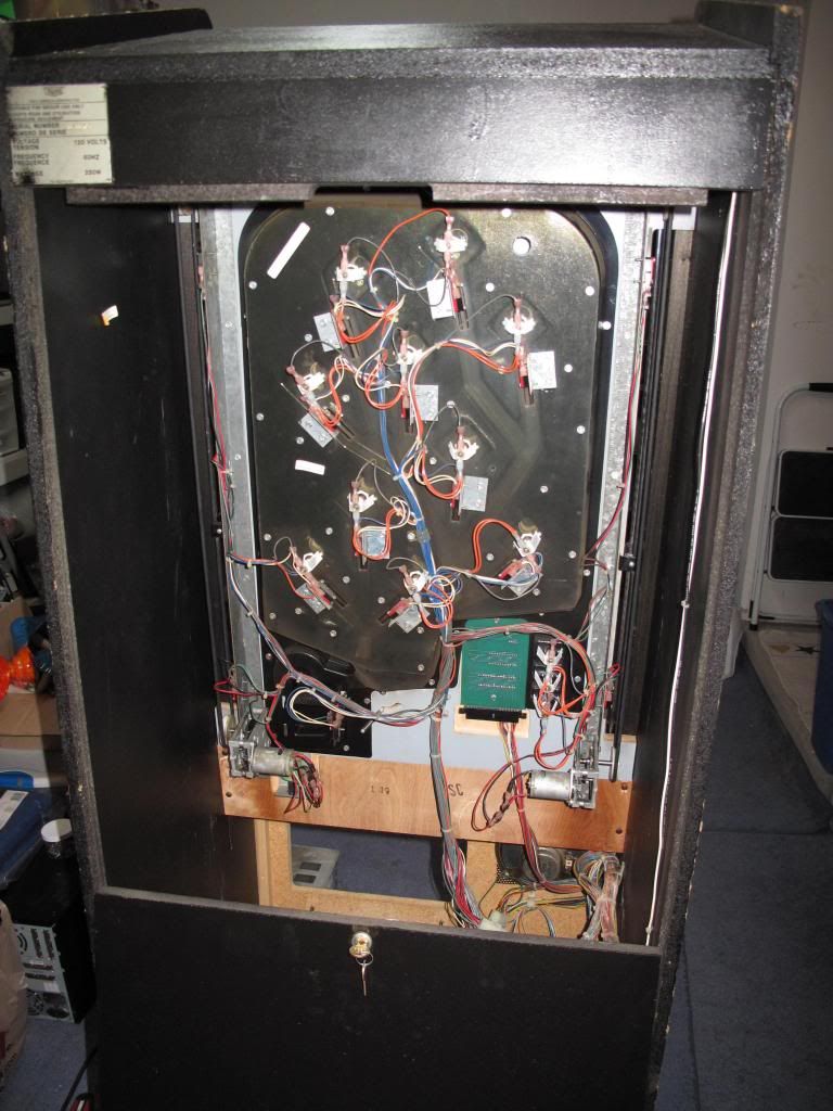

In the process of stripping all of the parts so I can work on the cabinet:

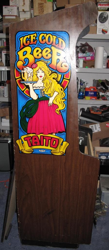

Here she is, stripped bare, bondo'd, & sanded:
I should note that stripping all of the old wood-grain vinyl and black vinyl from the cabinet was fairly trivial once I started using Citri-Strip. I started with a heat gun, but that was pretty tough going and I was worried about overheating the particle board cabinet. When I used the Citri-Strip, I only left it on about 25-35 minutes and then scraped it all off...keeping it from potentially seeping in to the particle board. I then used a little amount of Citri-Strip's after-wash to prepare the surface for painting. Everything will get a paint coat before vinyl re-application.

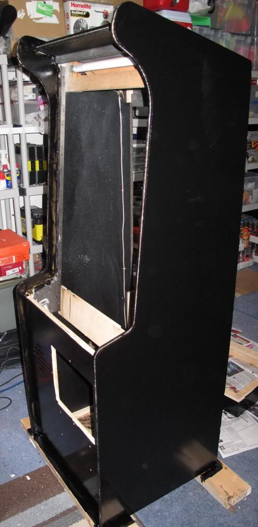

Just finished painting the first machine...base coat of satin black before I apply the black vinyl and wood-grain vinyl to it. Have to wait for it to dry, then will hit it lightly with fine sandpaper to even out the surface before applying the vinyl. The camera flash caused some reflections.
I think I'll let it dry overnight and hit it with the sandpaper tomorrow. I used oil-based black satin and a fine foam roller.

I'll be watching. This may sound stupid but won't oil based paint affect the vinyl's ability to stick if not right away, over time?
I'm going to defer to Bill @ ChompingQuarters.com on that one. He's done a lot of restorations and when you're going to put vinyl on it seems to be the general wisdom to put a coat of paint on first. But going oil-based vs water-based on that paint is a point where I'm not sure about the long-term ramifications. In my case for this one, my Ace Hardware had satin-black oil-based pre-mixed at a good price...they would have had to custom-mix the satin-black in water-based paint.

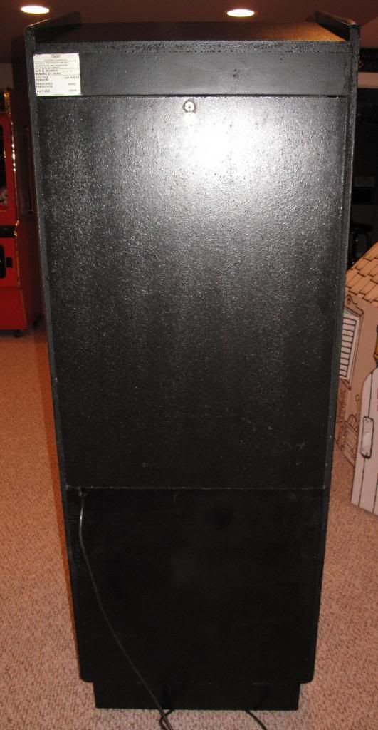

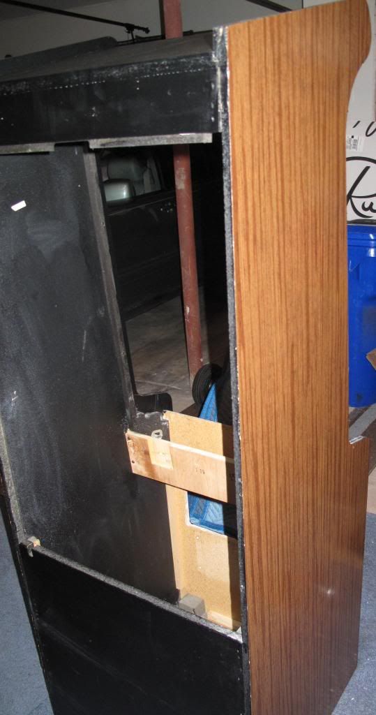

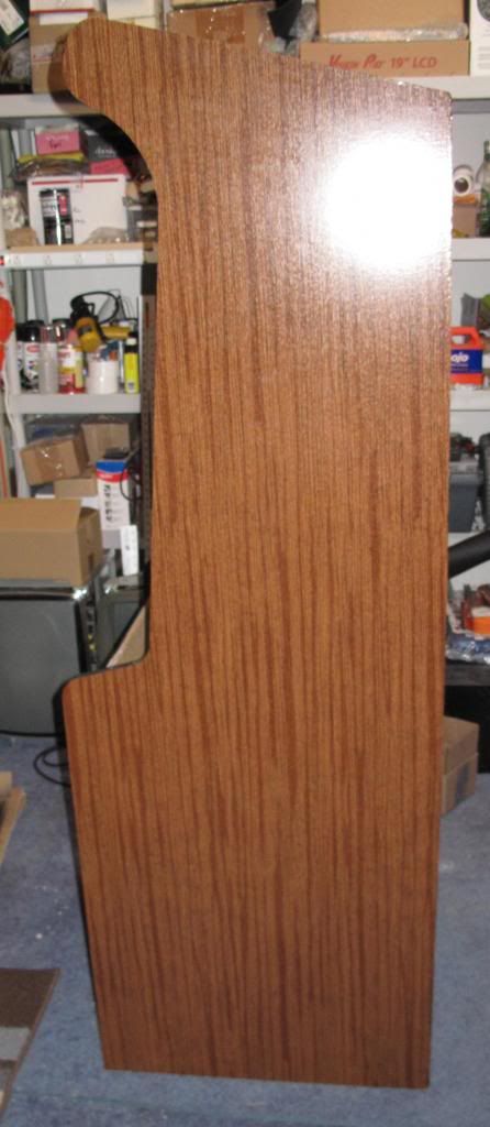

Well, I *finally* got a chance to work on the vinyl application on #1 (this week has been very busy with regular work, including bleeding into the evenings). I started with the black vinyl. And I found that I should remember my old adage: "Don't let perfect be the enemy of good." I ended up with a couple of small seams where I had to put sections of black vinyl together. When Ice Cold Beer was originally assembled BITD they put the black vinyl on the inside of the cabinet sides before the machine was assembled because that is one solid piece originally. The only way I could replicate that look would be to rip the cabinet apart and then put it back together. Simply not worth the effort, so there are a couple of very minor seams where sections of black vinyl meet. I couldn't get one contiguous piece to go from the bottom all the way up and then to the top back. Will be doing the front section tomorrow, then working on the wood-grain vinyl application on the sides. Learning from #1 and will be applying those lessons to #2 shortly.
After traveling for work most of this past week, I got a chance to get some work done on ICB.
Here is the wood-grain vinyl applied to candidate #1:

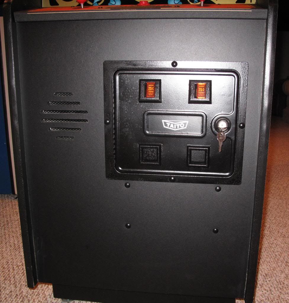

I've also re-painted the coin-door, will hopefully have time to re-install that tomorrow and work on the control panel. Also need to put the new base on the bottom of the cabinet. I always put t-molding on last.

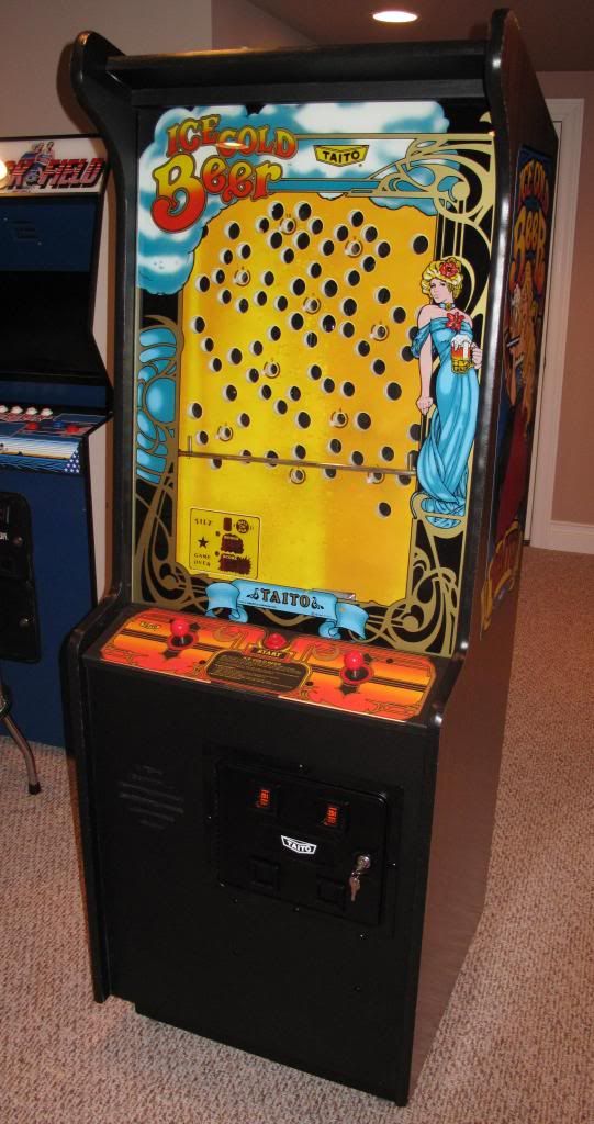

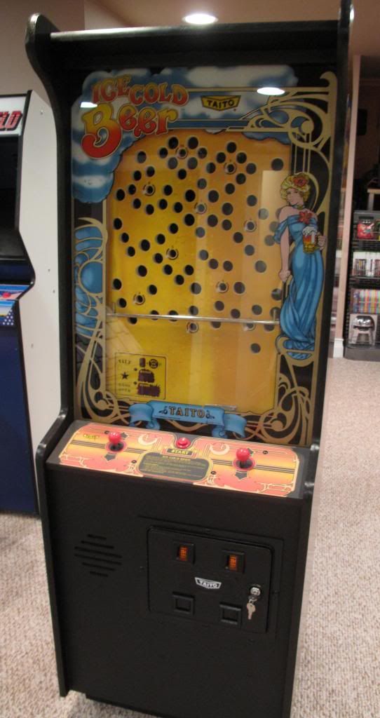

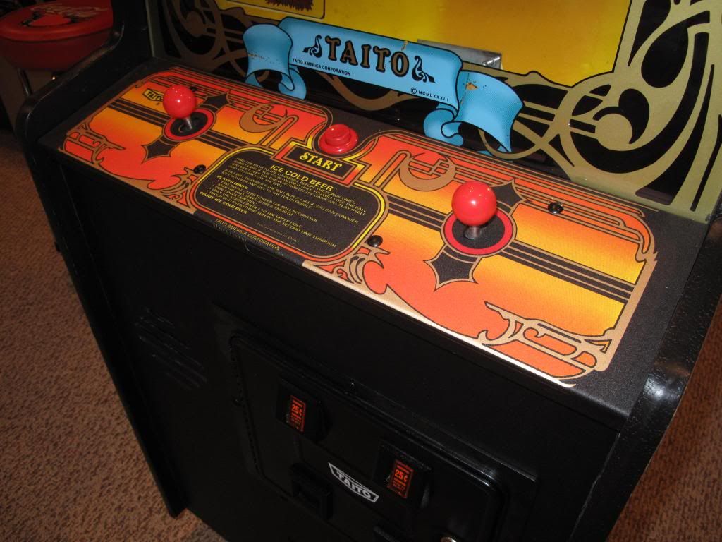

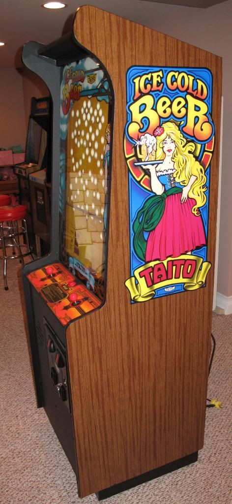

Pics of machine #1, downstairs in its completed state:
The only thing this little lady needs is a nice fresh glass front...so I'm looking forward to that project. The cabinet is the original survivor, simply fixed up where necessary with new vinyl throughout and new artwork. The insides are so clean you could almost eat off them.
I need to figure out a free-play option for it though...I try to keep all my machines on free-play if possible.
Here's an excellent wood-grain vinyl choice for these machines. Simply go to eBay and search for "3M Di-Noc Marine Teak Wood Grain Vinyl Sticker Decal Roll Adhesive Sheet". You'll find that the Marine Teak color is excellent, a little lighter than the original, but looks amazing.
