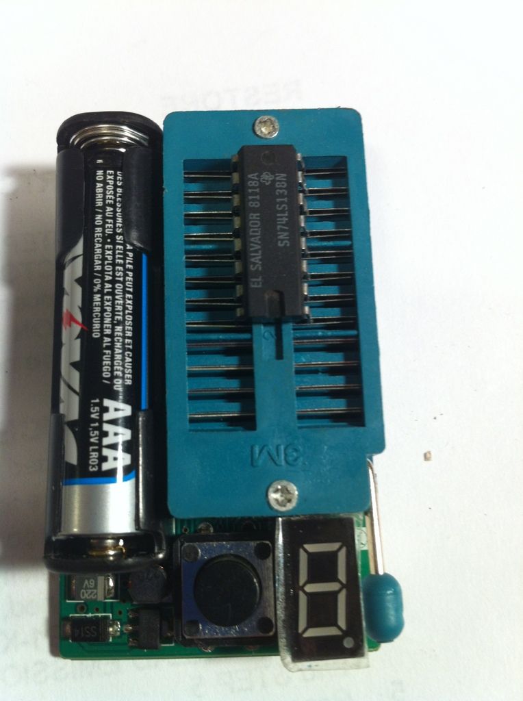

I buy a fair amount of TTL chips from a local surplus electronics place. Some are pulls, and some have been stored for years in unknown conditions. They are cheap and convenient when I need something now, so I take my chances with them. When I work on something, there is always that thought that I may be replacing a bad chip with another bad chip, therefore wasting time chasing issues that don't exist. For this reason, I've always wanted an IC tester, but didn't want to lay out the cash for one, considering how many TTL chips you can buy for the cost of one.
I was browsing Ebay a couple weeks ago and came upon a strange looking Chinese device that claimed to be able to test 74xx chips plus some others for $39.99 & free shipping.
I was skeptical to say the least, but figured I've wasted money on stupider things, so I hit the "buy it now" button and waited.
It came from China in about a week, and I was fully expecting to point and laugh at myself when I realized I had gotten duped.
I ran down to the garage and put a 74ls138 chip in the socket and pushed the button. I'll be damned, the 7 segment LED flashed "7 - 4 - 1 - 3 - 8"
I tried a few more chips and it identified them as well. I then lifted a leg on a chip to see if it would report it as bad, and sure enough, it flashed "e - r - r" as it should for a bad chip.
I'm not sure how extensive of a "test" this thing is doing, but at the very least it would tell me if there is something catastrophically wrong inside a chip.
Interesting little device.

Would like to see you test some known bad and some more good ones....
Interesting for sure...
Agreed. I didn't have any known bad chips handy. I did "test" one IC that came back properly identified, then bent one leg up to simulate a fault in the chip and it did report "err" as it should for a bad chip. Not a true test of a "bad" chip, but as close as I could get for now.
I tested about 10 different 74xx series and a cd4066 and it identified them all properly.

will be interesting to see if this little device can do more than just identify the ic,most expensive ic testers have a logic routine they use to test the ic after identifying it, makes you wonder if they can fit all that in such a little device and for such a cheap price.
Well, they are pretty honest about it on e-bay:
Can test chip logic function,but don't test static current and working frequency, so this product only as a general electric appliance maintenance and electronic produce, is not suitable for use in scientific research. But it is enough to meet the needs of the most cases.

I'm no electronics expert, so I don't know if that means this tool is good enough to determine if a chip is suitable for use or not. At the very least, it will tell you if there is some sort of physical disconnect inside the chip casing that would keep it from functioning properly.
