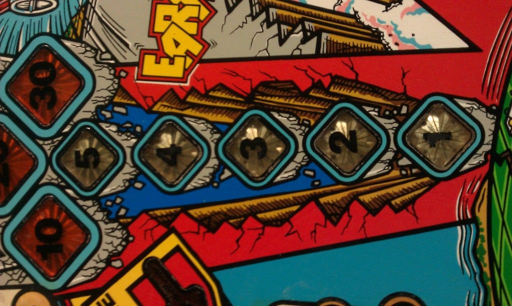

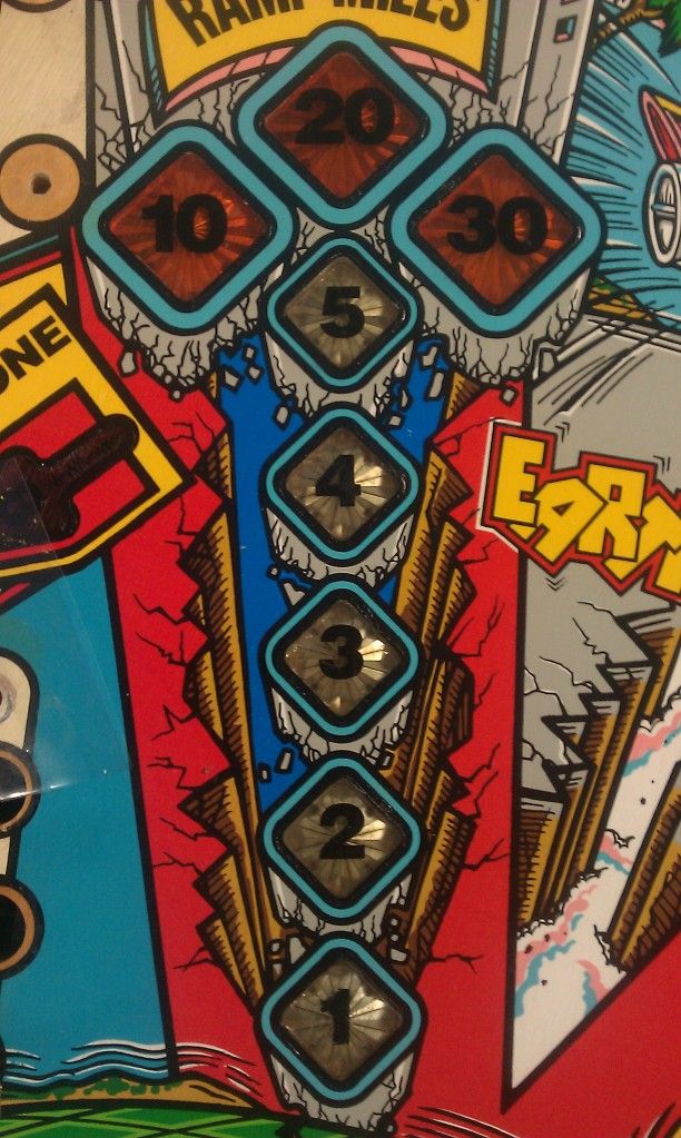

Mine did that too, when the bubbles in the mylar form the adhesive hardens taking the screened inserts with it. One repair method is to remove the inserts, wetsand the inserts, then apply the replacement decals, I thought that was much for mine so I touched mine up and it looks pretty good, lots of the black outlines were bad so I touched them up and it looks pretty good..
BEFORE:
AFTER:
