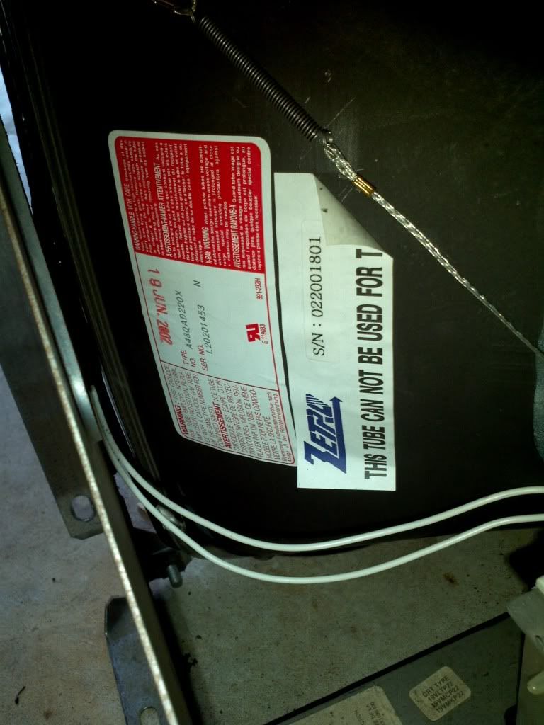

I replaced an old monitor with a new one on my icade and now after adjusting all I can, picture is just to narrow? The monitor is a zetro in which I had never heard of and the board is a 69x1178_100. Plz help me if u can.

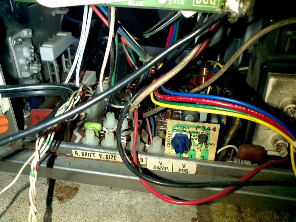

You've adjusted the vertical size out all you can? Not sure what monitor that would be as I am not familiar with the brand.
Yes ive ajusted it out all the way:( When i bought this monitor it had no chassis at all, so i installed it with my existing board. plz help me!!!

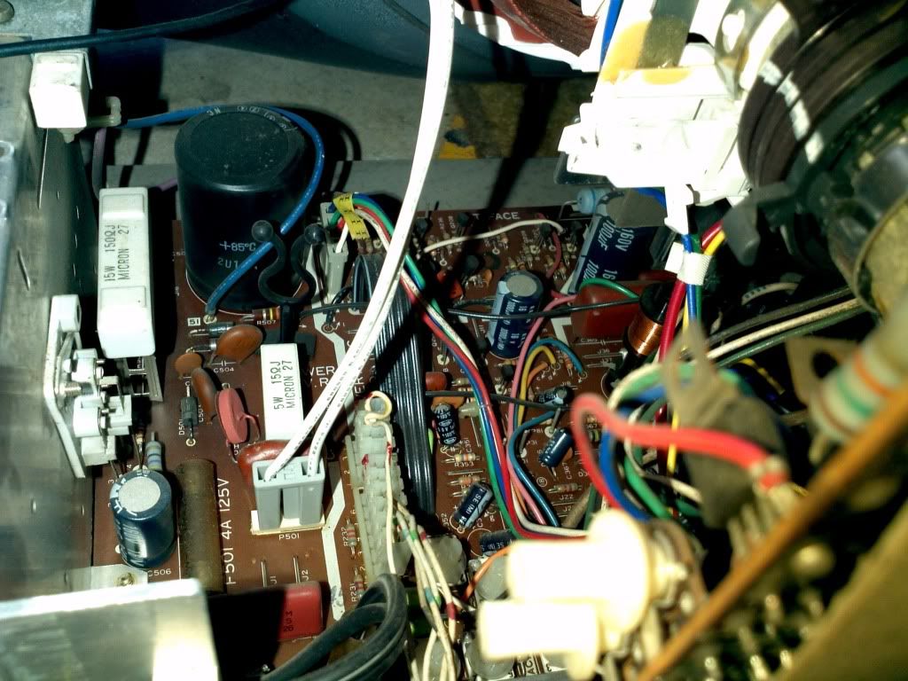

Take some pictures of the monitor chassis. It could be possible that you just have a bad vertical pot that reared its ugly head when you did the swap.

And you have a Wells Gardner K4900 model monitor chassis. (not Zetro...)

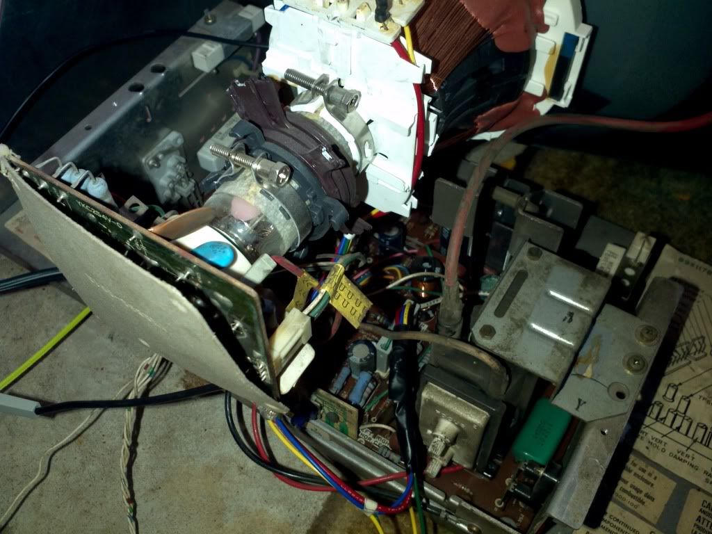

I agree that you need to swap the yoke, use the yoke that came with the K4900 chassis.

Do you have the old tube? You need to remove the yoke from the old tube, and put it on your new tube.
Edward
and that's only easy to do if you say it quickly!
unless you are pretty polished at it you will all sorts of convergence and purity issues - I would be seeking some help from a technician at this point
