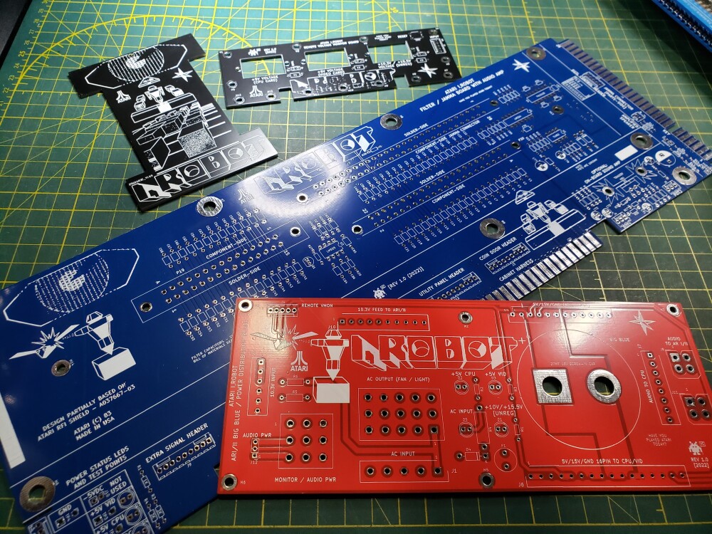

I thought this would be fun, and it got a little outta hand.

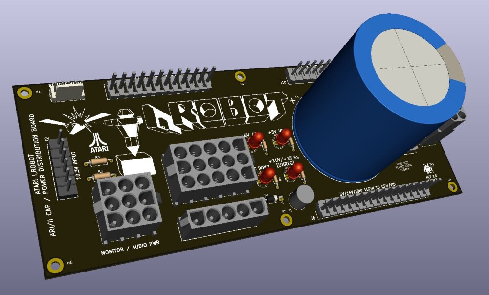

I have never used KiCAD before this, or any PCB design software before, so I know it's a bit of a rats nest... I tried my hand at coming up with a replacement for the switching power supply for I Robot if I can't find an original one.
This would use 2x ARII and a raster power brick, but in theory would output all the proper voltages and functionalities (except the 145VDC for the monitor, which I don't have anyway).
For my I,Robot, I took a slightly different approach taking the FireFox dual ARII power topology as inspiration and also adding an extra BigBlue (ie. in addition to the one on the Power Brick). The distribution board uses the same connector definitions as the original power supply.

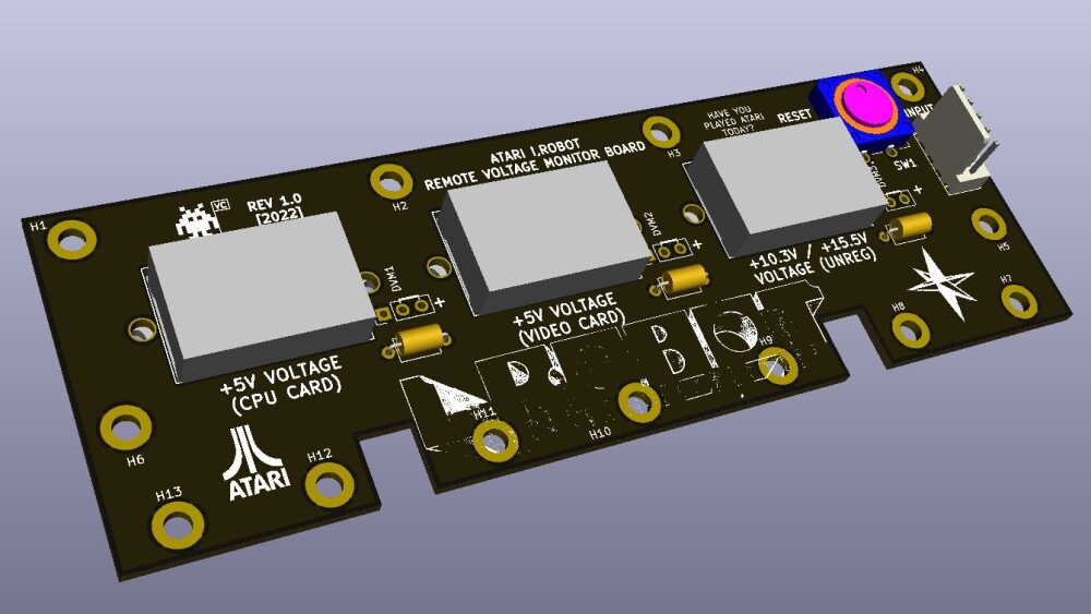

Then I added one of my remote voltage monitor boards. LOL - those were the days. :)
KICAD IS FUN!!!!
This is how mine started out... Just directly routing all the connections from the dual ARs while matching the footprint of the original.
But then I started thinking "Well what if I just add this regulator, then I can match the spec of the switcher..." and it spiraled from there.
What did you do for the I Robot power on reset?
I'm curious why there needs to be two ARII boards?
My I, Robot had issues with the power supply despite it being rebuilt so I decided to put a raster brick and single ARII in there(without hacking the harness) and it runs great.
I'm also using one of these and it's able to save without issues.
For FireFox the total +5V load exceeds the recommended ARII amperage for the entire boardset.
For I,Robot, the total load is not as high but it seemed like a reasonable thermal strategy to dedicate individual+5V to the CPU and VID PCBs.
I believe, FF and I,R shared some engineering similarities - not just the AC/DC power supply and Disco monitor and evolved as one power solution became more problematic.
RESET was a 200msec 555 circuit likely copied from the power boards schematic.
The RESET function, however, was incorporated on my "jamma/OG" board and not on the power distribution board.
As it turned out, I did not need the reset nor the jamma board. My I,Robot has repro OG wiring. LOL
