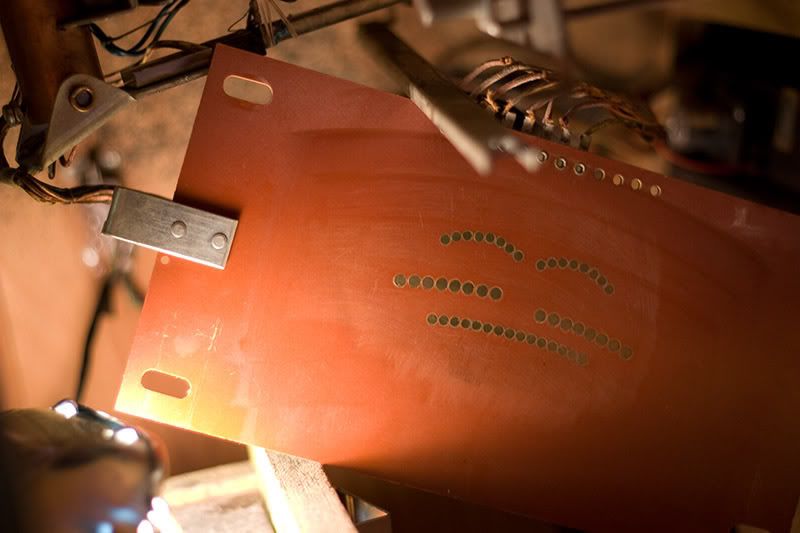

Typically, the mounted gun assembly directly drives a flat rod on the underside which has one or more spring-loaded brass styluses that drag across a bakelite board that has different brass contact points or areas. Very low-tech! Your trigger pull would connect the circuit, should it be aligned correctly.
Moreover, with moving targets, there will be "zones" --multiple hit areas-- which much coordinate with the target's current position. The target's motion will trace back to a bakelite board with spider fingers dragging across it during the motor's operation. If it is, say, in the third "zone," only a trigger pulled while the gun's tracking stylus is ALSO in that's target's contact point #3 will count as a score.
These points can be rather small and hard to align. The most frustrating is a stationary target that you have aimed well, but keeps scoring as a miss because the tracking board is just a millimeter off.
Here is a tracking board from a 1973 Midway Wild Kingdom
The top two arches are "leapers," the next two are a tiger and alligator, the long bottom one is an elephant that runs back and forth across the entire playfield.
Upper left corner is the bottom of the gun assembly and connected rod.
The board has been pulled from its mount to be photographed.
