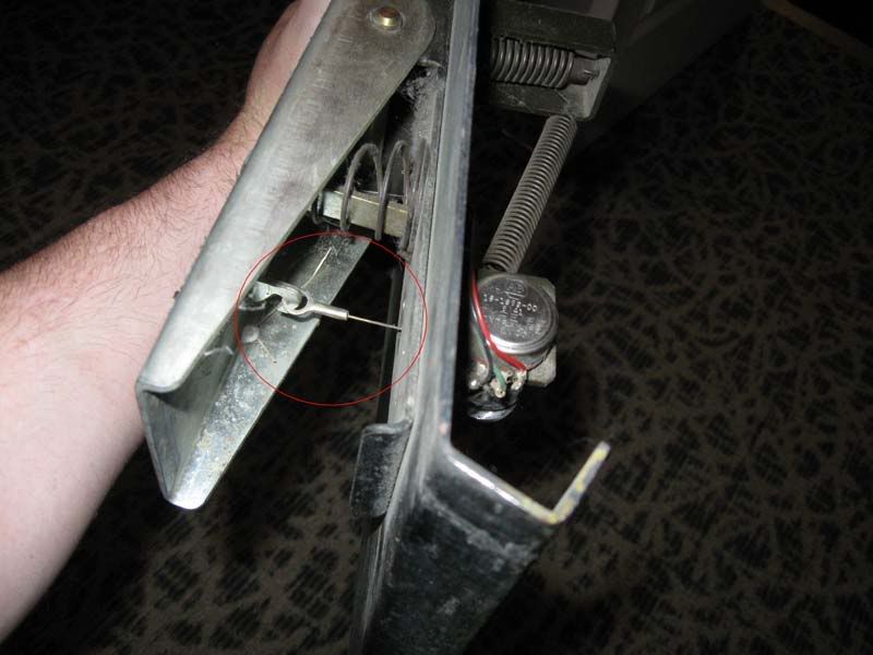

NIIIIICE! Now, unfortunately, the gas pedal isn't working...something to screw around with today after work it seems.

Good news... during lunch today I pulled the pedal assembly from the Pole Position and found this:
Ah! Nice simple fix! It seems the pot itself came loose over time, the wire then eventually work its way off the hook in the pedal.
Fixed:
Works great now! I do have an issue with the harness though. It seems to be 50/50 whether the game will boot if I mess with the harness at all. Leave it alone and it seems to start up over and over.
