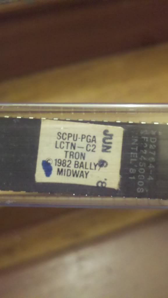

I've got a tube of TRON ROMS that I picked up as part of a box of parts. Some are marked June 6 and others are June 17
Wow.... very interesting...
Jun 6th, never seen that before....
I've also checked in MAME,
and they recently added an Aug 9 version
(... which only differs on eprom D2 from Jun 25th )
Seems like a whole crop of undiscovered versions... ;-)
It would be worth getting a dump of those Jun 6th eproms as well ...
If you wish do to so, but can't find anyone locally,
I'll gladly dump them and return them to you...
LMK,
Cheers,
Steph
I can dump them and send you a copy. I think only two of the roms had the June 6th date.
