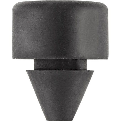

Has anyone found rubber bumpers to rebuild Galaga joysticks?
Part number 0017-00041-0616 - Rubber Bumper , 90 Durometer, 2req'd
Measurements I pulled from original and original metal attached in pic.
Original looks to be tapered but I will take flat for now if no one has found a true replacement.
Let me know what you may have found or if anyone has any NOS on these.
Thanks!

So I received these GM parts to attempt to use in Galaga rebuild. The size is exactly what I thought it would be. The diameter of the land is smaller and the thickness of the pad is shy by about 0.015"-0.020"
The durometer is not listed, but I can say that it is hard with a tiny bit of forgiveness as opposed to the fossilized, rock hard, dried out 40 year old ones that everyone has. I cannot compare to a NOS as I was not able to find one, but I think that these will end up being a great alternative. I just took apart my backup Galaga. bent it back to square, cleaned it up and hit everything with 4 coats of lacquer. Will let it setup over night and will finish rebuild tomorrow or the next day at which time I will be able to get a game in with these installed for a final opinion.
Overall I say they are a solid 8.5-9 out of a possible 10, if there two dimensions above were a little tighter, they would be a 10/10 for sure.
Hope this helps future Galaga joystick rebuilders.

I did see that one, and the ones he selected BB41 Pack of 15 Rubber Button Bumpers A=1/2, B=9/16, C=1/4, D=5/16, E=3/8 don't seem to be as close to stock as the ones I found.
As promised here are pics of original and then new bumper installed in cleaned up joystick. I shot a video showing the range of motion (yes my house is a circus sideshow all day, I didn't even notice the music), it is hitting the bumper not the metal, the sound you hear is the leaf switch off by about 1/16 of an inch, I forgot to reshoot the video after adjusting.
bumper has a flat land like original, not the mushroom type that was found in another thread.

Forgot to report back, I have had more than a couple people at my store who were avid Galaga players note how nice the joystick felt on the one I did above.
So I think it is a win!
