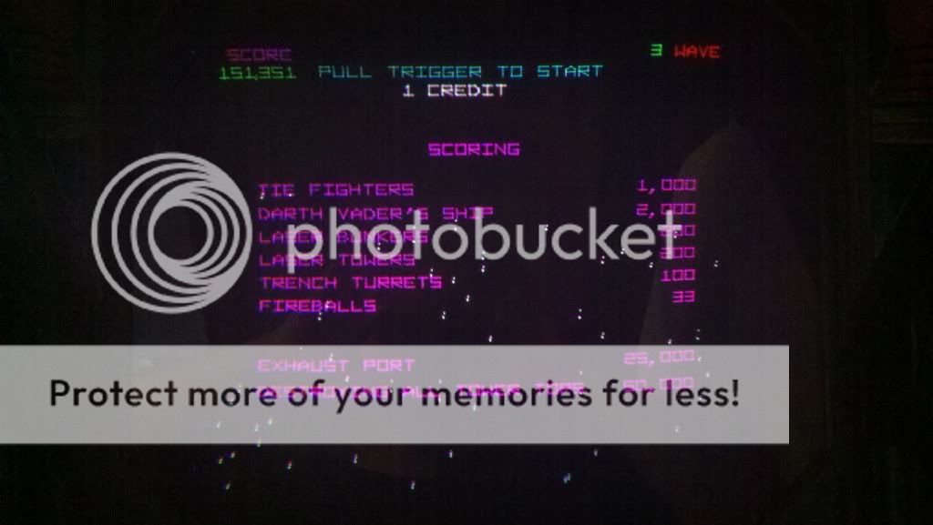

I F***ed Up... Help, 25" Amp Deflection - SOLVED
I wasn't paying close enough attention when I plugged in the deflection board. I had the yoke wire unplugged. I grabbed the wire at the connector and got zapped by it. I now only have the lower right quarter of the screen. I am thinking I hosed the yoke. Is one quarter screen a symptom of a messed up yoke? I replaced all 8 transistors that go on the heatsink since they were old anyways and nothing changed.

Problem solved! I had two non conductive nuts on the large transistors on the heatsink. These were not making contact with the base to the board.
I fixed another guys parts board and since I had my board out to test his I replaced his missing ones with mine. Then I found some that fit mine later. Oops! Simple fix, just overlooked it.
Thanks for all the help. I should have tested that contact when I did the transistors. The fact that I shocked myself then had an issue sent me and you all on a wild goose chase! I don't get zapped then I go after the nuts first.
It's so basic, I hadn't even thought about something like that.....at least I was close (physically) ;) Nice to see it's back. Is it your camera or does the text look really that purplish ?
