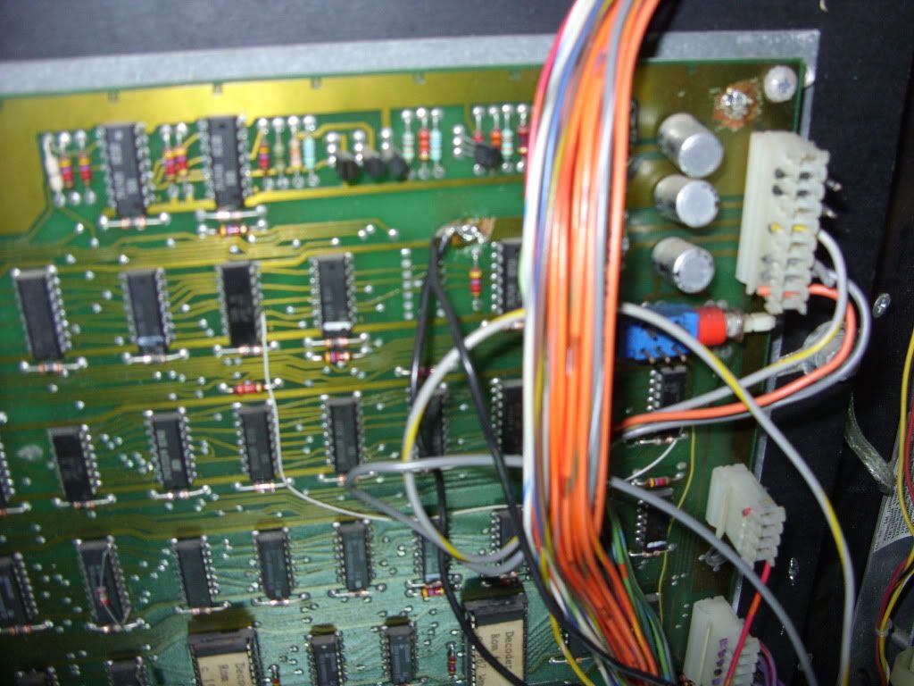

I have a lot of respect for you repair guys - wether it's monitors or system boards my hats off to you. I can only imagine the piss poor hack job/failed repair attempt victims you've had go through your hands. I'd like to hear horror stories.
I spent 2 hours trouble shooting a monitor board only to find out (after moving the wiring harness enough to realize) some jack ass replaced a zener diode with a capacitor which lovingly fried 7 other components. This is the 3rd board I've repaired that someone shot gunned in the wrong parts. :D
I only wish that I had saved some of the pictures. The Williams Repro harness was born out of frustration from all of the poor hacked up wiring harness' in Williams cabs.

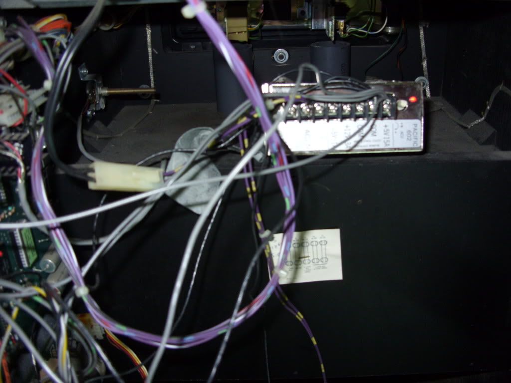

Saw one Robotron Cabaret that had all of the connectors in place, but the wires were soldered to the boards. Yes it did have a switcher very badly hacked into place.
Saw a poor old Moon Patrol that had been converted into a multi with Clay's kit. Wiring was such a rat's nest, I would be scared to plug it in to the wall. Had a big ass 120mm fan blowing on the switching power supply to keep it cool.
Have a Stargate power supply in hand that has individual diodes tied together to replace both BR1 and BR2.

Yes My Robotron Caberet was hacked to hell. They had a switcher hidden duck taped above coin door, Tape was prob atleast 5-10 years old. switcher fell off when I moved it. Harness plugs cut and soldered to rom, main board and PS. yanked it all out, put in a nice board set, an original rebuilt power supply and my new UR harness, for temp use. As soon as my friend from Seattle repairs my original harness. It will be all original and unhacked again. Looked like a bomb went off in it.

Just got done working on a Tempest. Someone had put sockets in, so swapping chips was easy. Unfortunately, when they pulled the original chips the pulled traces too. Pulled them so completely you couldn't tell they were even there. That took a bit of checking with a meter and schematic to figure out which lines were missing. But after several hours of verifying traces, and adding some wire runs, she's back up and running. Now to work on the one that's smoked. At least I can see which parts are definately bad, it's the ones you can't tell if they were smoked that's going to cause me grief.
I repaired a bally/stern lamp driver board last night that someone else had tried to fix... and shorted a couple of pins together when they replaced a socket. That took me a while to figure out...
