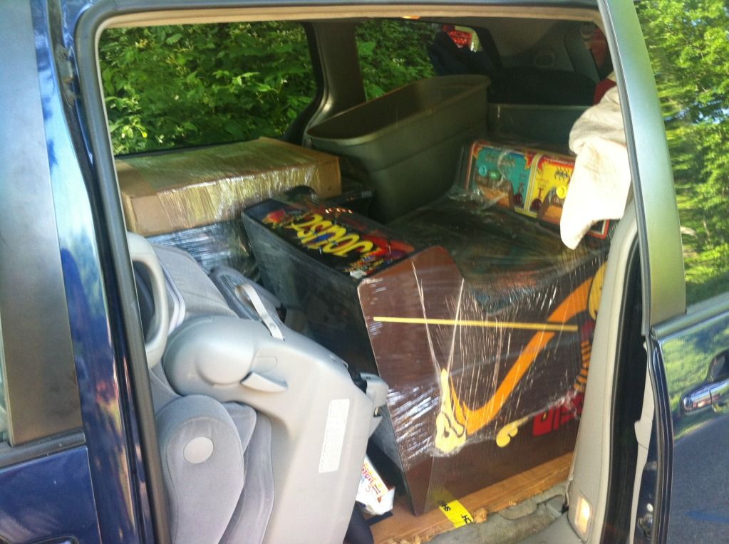

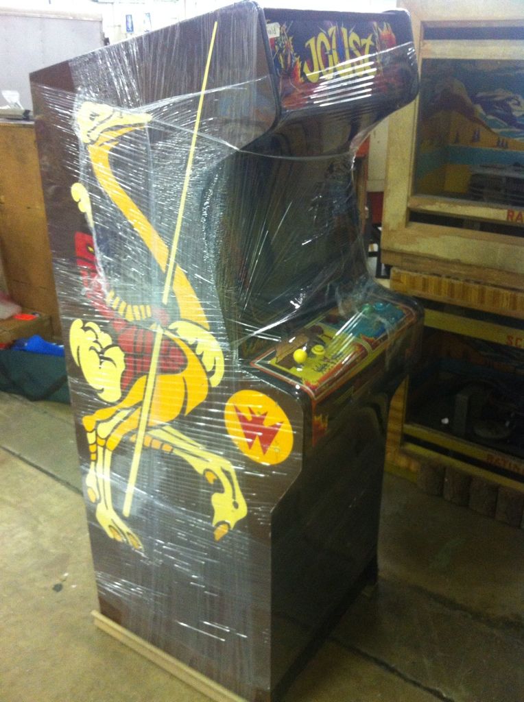

Basically bought it as untested off the convention floor at Allentown for $200.
Shrink wrapped for the trip.
Who says minivans aren't cool? They can haul plenty. My luggage, Joust, and a Popeye cocktail table all fit nicely.

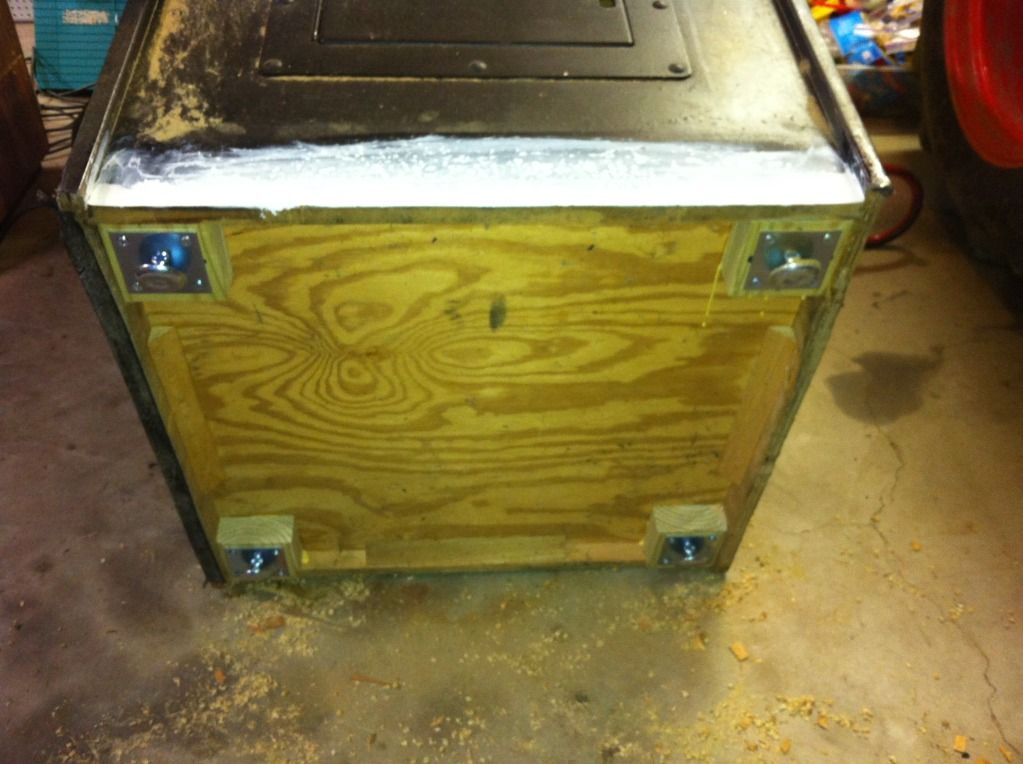

Biggest cabinet issue was the feet had collapsed and tore loose.
So I replaced the blocks with some thicker ones, added leg leveler plates and new leg levelers.

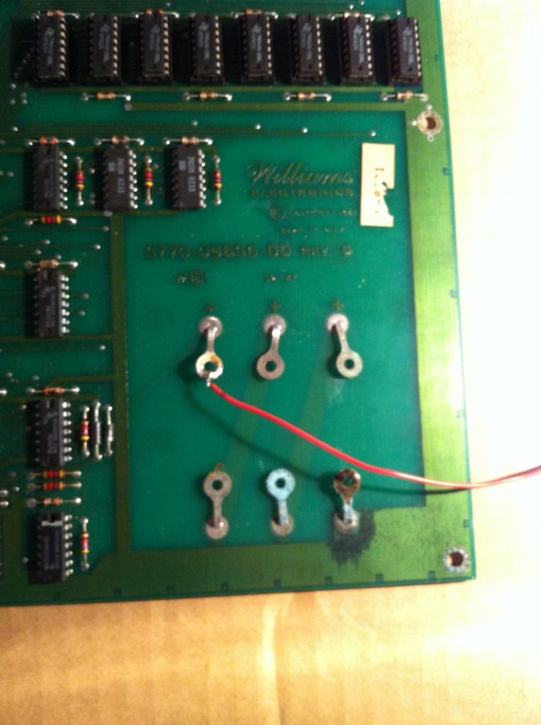

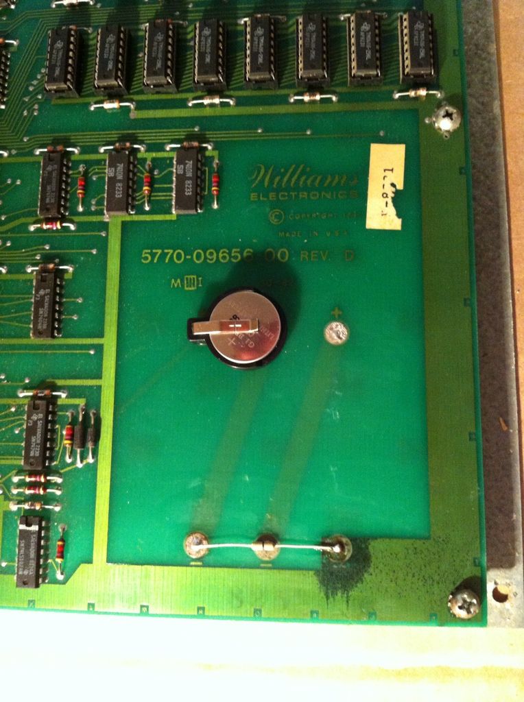

Next issue was the battery holder, the remote pack that was installed had corroded and fallen into the bottom
thankfully sparing the board any severe damage. I removed the remnants of the original battery holder and installed
a CR2032 lithium holder.

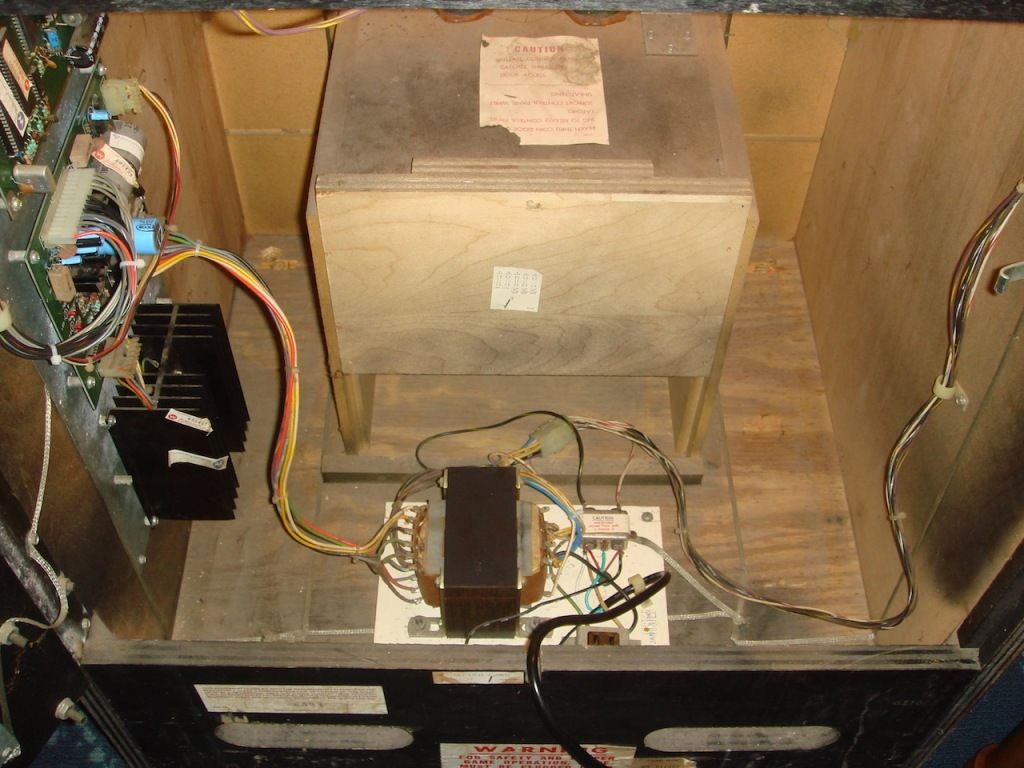

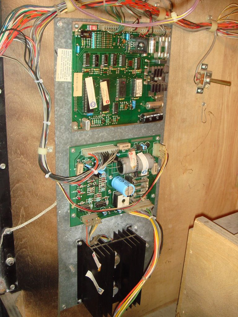

As it was bought, it had an undersized switcher installed,
but given that I had an original linear supply that was rebuilt, I opted to reinstall the original.
I removed some nasty wire splices and returned the wire harness to it's original connectors... cleaned up very nice.
This was a bit of a decision for me, I love switchers,
but having an already rebuilt original supply on hand pushed me in that direction.
With RAM issues caused by the switcher on occasion (corrupt HS tables and settings),
seemed to be the best course anyway for most Williams games.
New connector can be seen on the top left of the power supply PCB.

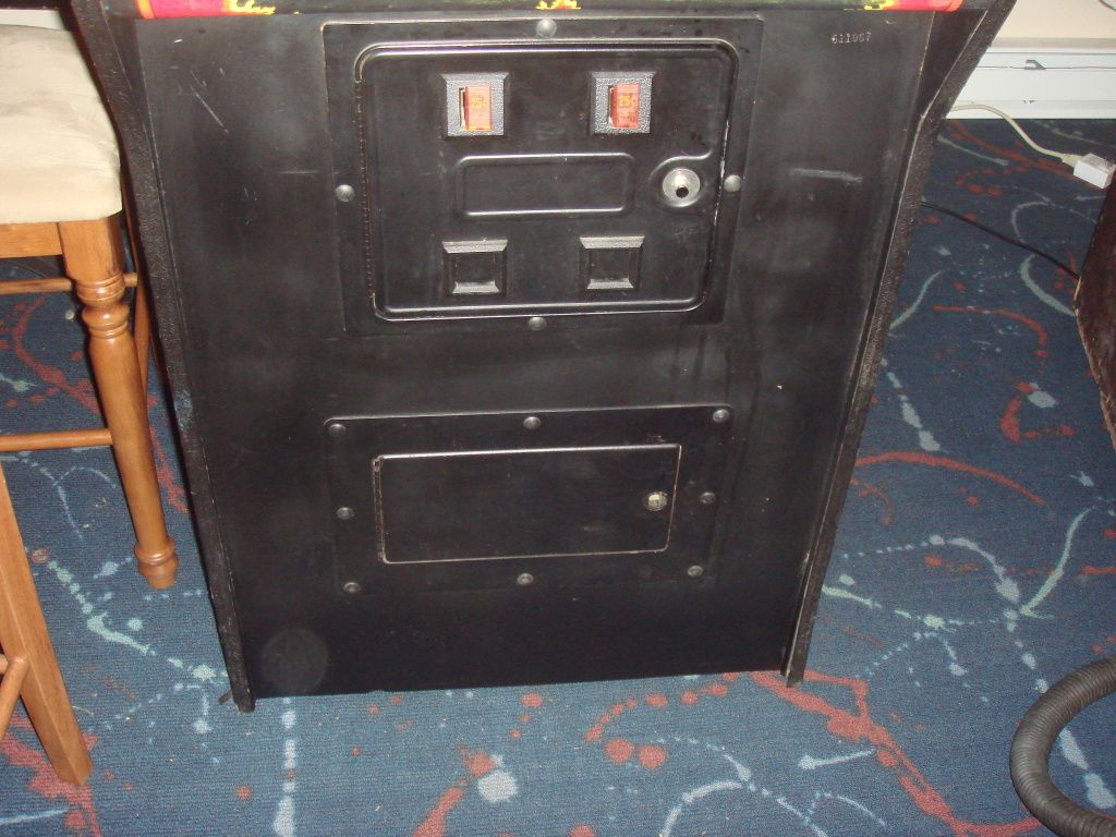

With the inside complete, it was on to the coin door to remove the credit switch and install token mechs.

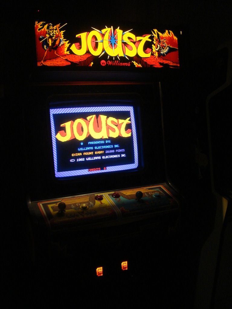

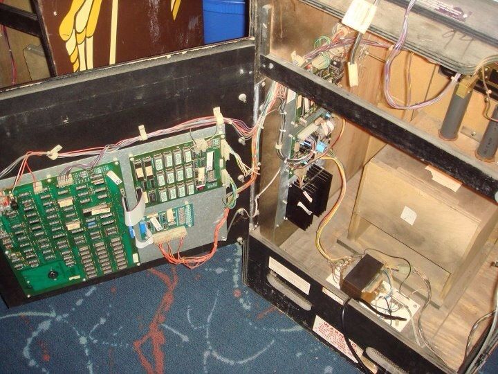

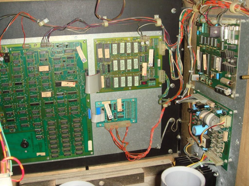

All in all, no board issues was a huge blessing.
Everything fired up (even with the switcher) just fine.
Biggest operation issue was the absence of the battery which caused a memory fault, had to open the coin door (memory interlock switch) to reset.
Had to do a few adjustments on the monitor, but it looks great now.
I'm always amazed at the array of boards in these machines... especially when you compare this to a JROK!!
The 2nd picture is the inside of my Multi-Williams JROK cab, and yes, that is where the rebuilt supply came from! :D

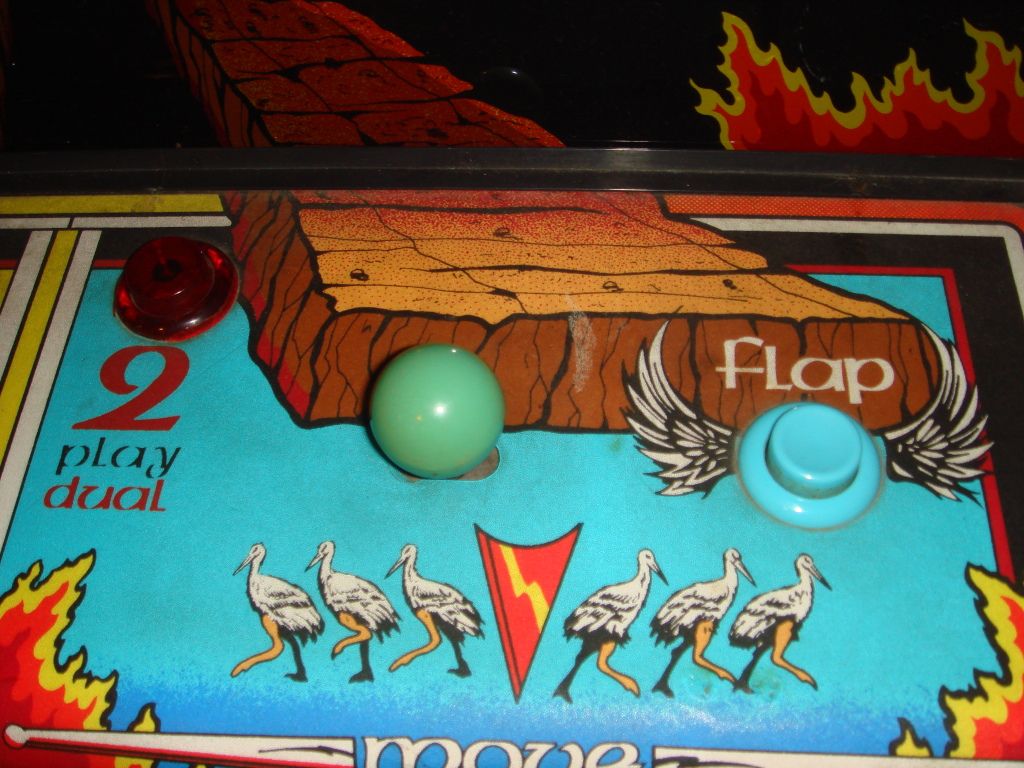

The joysticks are a little wore, sloppy feel to them,
CPO has a little too much wear for my taste (burns along the front curve mainly).

Arcade Shop has Williams two way bases if you want to rebuild the joysticks back to new feeling.

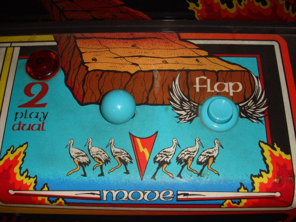

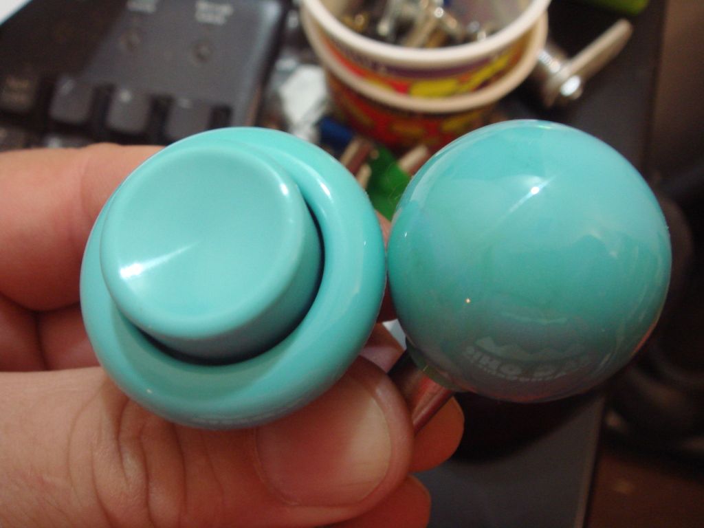

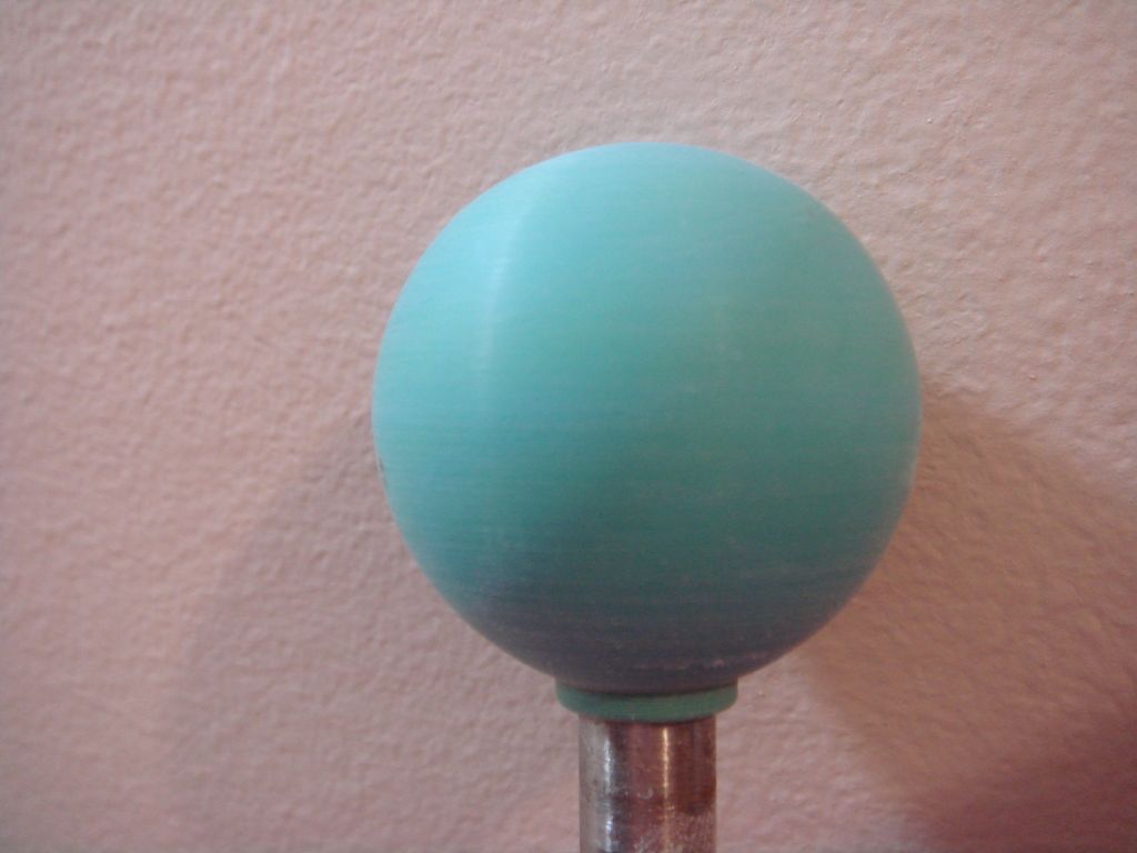

I did the blue joystick last night and the result was very nice! I thought I was going to have to buy new joysticks!
Control Panel before:
There is color!! Just started sanding BTW.
Finished sanding
Polished and now matching the button color.
Looks much better in the control panel, now to clean the CPO
