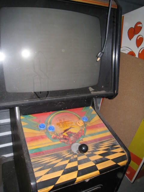

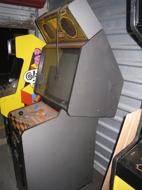

Well, I didn't really almost die…it didn't fall on me or anything, but it took so damn long I felt like killing myself. So are you ready for a long story with lots of pics! Pull up a chair and get the popcorn! This project started out as a poorly listed E-bay auction for a "non-working" 720 that I ended up winning for $95…with $450 shipping of course. Here's what I bought as was shown in the auction:
The seller stated that "It worked when it went into storage", but I found out later that would have been impossible. As a nice addition, I actually received an extra joystick with it for no extra cost!

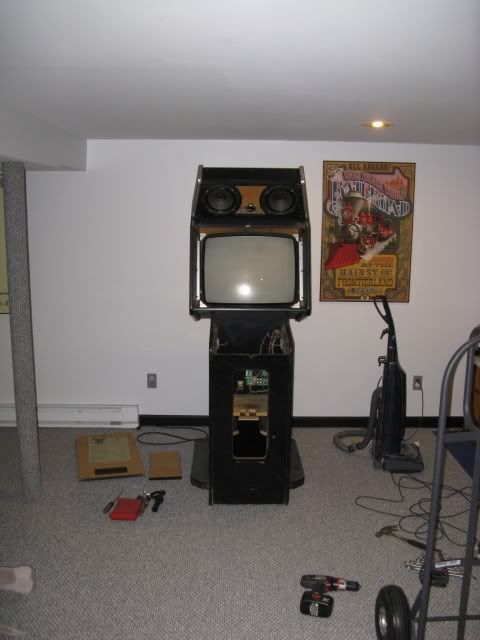

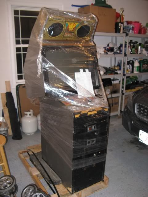

So it showed up to my door looking like this:

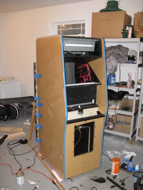

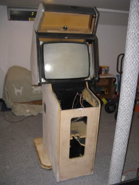

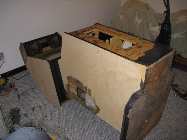

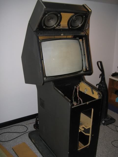

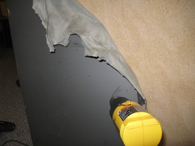

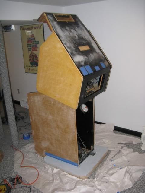

I unwrapped that baby and rolled it around to the back of my basement in the snow by myself (no, it wasn't uphill and a 10 mile trip, but the 400 lbs sure made me feel like an old man!). I got to work stripping everything down, and found an original manual with it…of course, after I already had one printed and bound. The stripping process is always fun:

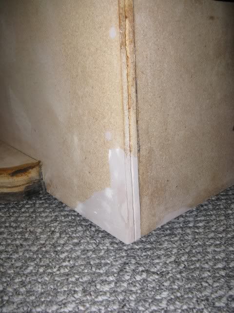

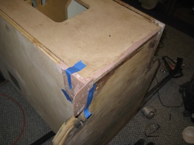

I had to Bondo the corner and fill in another few spots…gotta make it minty!:

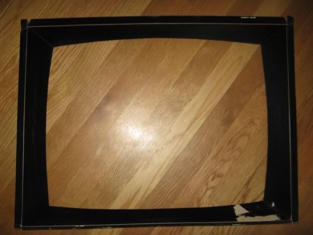

The monitor bezel was also crap, which I ended up painting:

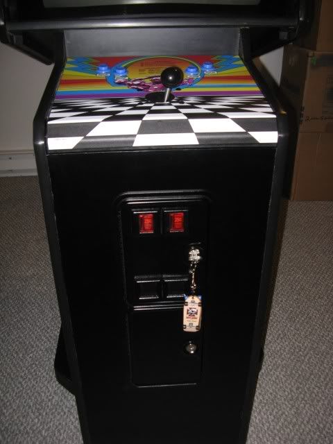

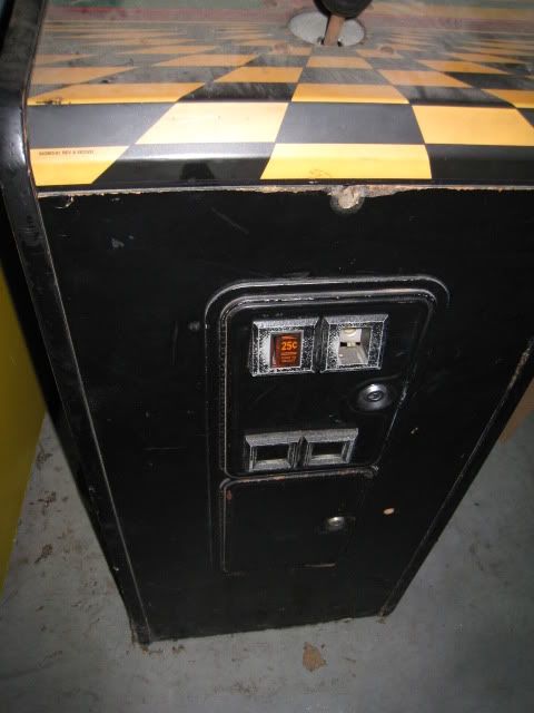

After completing that and replacing the light bulb, I painted the coin door and replaced the coin return buttons. They originally looked like this:

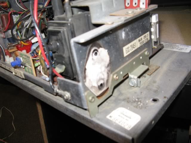

About now was when I started working on the "non-functioning" part. When I first got it, it played blind, no hum from the monitor and no glow from the neck. I don't know jack about electronics…asked some questions here and had a repair guy look at it, but he self-admittedly didn't know much about monitors. After looking a bit more, I found that I was missing something:

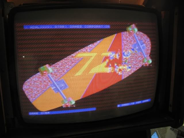

I was missing the transistors on both sides. Ordered those, waited a week to get them,, replaced them, turned it on and…nothing. No neck glow or anything…great. So, I gave up and sent the monitor board to Chad at arcadecup.com. Great guy. Wait my turn watching the queue for about a month, he gets to mine and gives me a call. "Hey Derek. Did you know that you were missing the screws for those transistors on the sides? I just put them in and everything worked!" Holy crap. Well, I had him replace the caps while he was at it. He mailed it back to me, and Voila…I had a picture…except it looked like this:

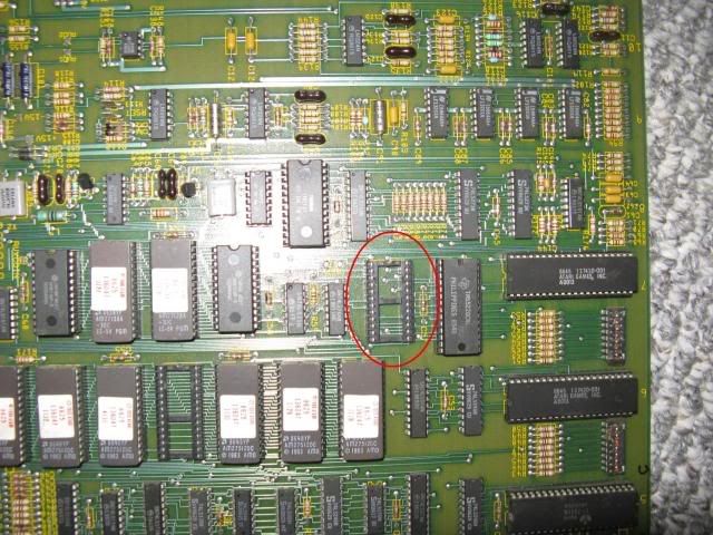

And my controller didn't work at all…didn't even register as being there. That's when I enlisted the services of Francis at Ataricade.com. Again, fantastic guy…love this hobby for the people involved. We discusses things via e-mail…found out I was missing a Leta chip…great!
I sent him my boards to test other issues, and he just flat out swapped a working set with mine. Well, I got the working set, and they didn't work for me. So…after a midnight phone call or two, I ended up sending him my boards back, and he recommended sending mine to El Dorado.
Now, I was a little leery about them from some posts here and there about delays, etc. Well, I called John there and he said not to worry about it…he got them, replaced the connector and crystal and got it back out to me in less than a week…another A+ for service! So after I got them back, I replaced the power supply…just in case…and woo hoo!!!!

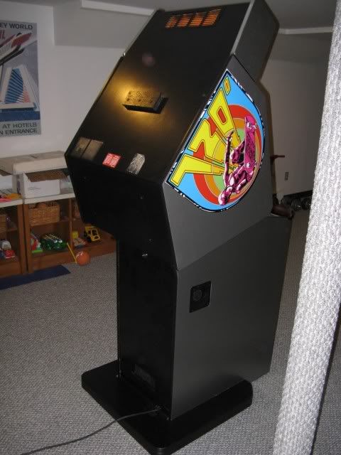

So in the end, I now have a fully restored 720 that took almost 4 months to complete…only about 1 month to restore, and the other 3 months waiting for stuff to get mailed all across the US. Without further ado:
And of course, what would a Jedidentist restoration thread be without my obligatory OMGWTF pose!
Yes, those are my original Steve Caballero boards from the late 80s as well as my VSW shirt autographed by Natas Kaupas. And I couldn't help myself and bought some Nike 720 sneakers as well…the kids in the office love them!

Thanks guys. Yeah, I repainted everything on back. I covered the stickers with painter's tape, so they're all original. I even replaced all of the leg levelers. I really could have had this done in a month if it wasn't for all of the waiting on everything. Oh well, good things come to those who wait!
