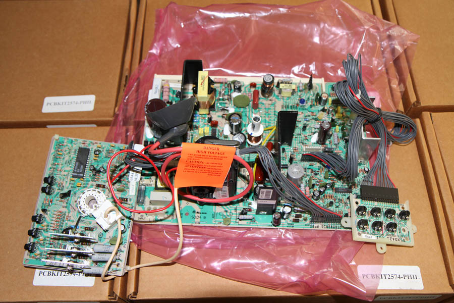

So I wanted to order a cap kit and new flyback for the monitor in my KI2 cabinet looking at some pictures it looked like a u2000 but I soon discovered that the u2000, u5000, k7400, and k7500 are nearly indistinguishable from each other, and not only do they look nearly identical but the capkits and flybacks can be different depending on the model you've got, making for a high probability of ordering the wrong parts.
I figured out a few easy ways to tell the difference and since I had a hard time finding information on the differences I figured I'd post up a guide..
MAINBOARD:
Method 1:
Using the schematics from Wells Gardner the location of a coil near the center of the chassis is a great initial indicator:

^unfortunately the k7400 and k7500 have identical board layouts so you'll need one other key to identification.
Method 2:
on the left side of the chassis board (the side with the fuse) there should be a board number that starts with a "P" this number should tell you which chassis it is:
P-717 = U2000
P-738 = U5000
P-763 = K7400
P-793 = K7500

For whatever reason, I always notice the difference in them at the flyback. The U2000 and U5000 have the flyback very close to the edge. On the 7400 and 7500 they moved it back farther, so you can tell very quickly if it's the older (bad) or newer (good!) board by how close the flyback is to the edge.
U2000, notice the fly is right at the edge of the pcb. Once you see that, you know it's a 2000 or 5000, if it has the jumper plug in the middle it's a 5000, if it doesn't, it's a 2000.
K7400 chassis. Notice how far back from the edge the flyback is? Really easy to notice at a moment's glance. So you know it's a 7400 or 7500, I usually have to check the tag at this ponit. You'll see 2574 or 2575.

U2000 has a small white plug in the middle, U5000 with 2 different headers (as noted previously by mod) .. and if ever you're stuck on K7400/K7500, the K7500 will have a black wire wrapped around the core of the flyback.
that's how I know the differences. you can go deeper with the K7400/K7500: one has a cap at C729 and the other has one at C731 instead. (going off my hazy memory)
that's how I know the differences. you can go deeper with the K7400/K7500: one has a cap at C729 and the other has one at C731 instead. (going off my hazy memory)[/QUOTE]
width coil locations on the PCB is also a way to tell them apart.
