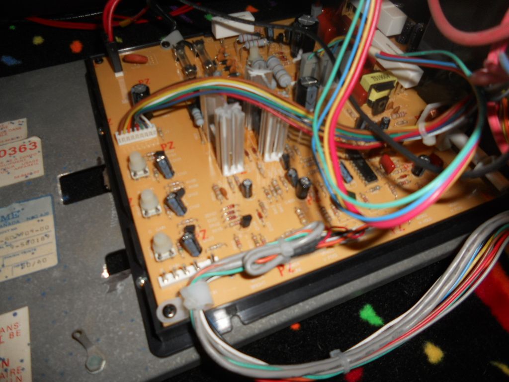

This is all new to me and I've always given these things away and stayed away from them. Last week, I found a NOS Pentranic and because of tube style monitors being harder and harder to come by, I have decided to use it.

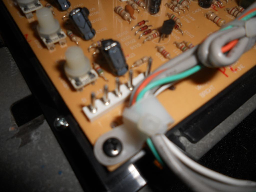

By looking at it, it seems that the input (red, green, blue, etc.) go into the area pictured below in the close up. Am I right in this assumption? This is unlike the Wells and Vision Pros that I've always dealt with.
Also, what is the wire position? Does it still go red, green, blue, ground, sync? And from which end does this start from? I notice that there is a slightly larger gap between pins 1 and 2 from right side. Any help would be appreciated and Thanks in advance! Here are pics:
i had one of those a couple years ago and that should be from left to right RGBGS (red, green, blue, gnd, sync). the sync is the furthest to the right with the larger gap.
