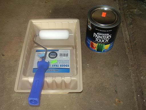

Guys, i know its been talked about to beat horses around here, the foam roller topics. I have read countless pages, and thank everyone for the advice.
Unfortunately, i busted up my HVLP gun, waiting on a new one, so i tried foam roller. Two times later, i am almost out of paint, so not going back for now.
Setup - 6 inch foam rollers (black) from SW using SW paint. End result - roller lines and orange peel city.
Technique - Top to bottom / when reach bottom, roll back up (to even it out), refill roller and roll it in the tray (so as not to have too much paint on there - real waste of paint i think).
Overlap slightly to the left until i reach end of cab.
My technique of course is not exact to that - because i ended up rolling over a few times more (dry) to try and distribute the paint - i guess thats where i go wrong. Too much re rolling without paint on the stick.
If i just roll once / roll back / leave it / overlap till end / will i have success or am i doing something else wrong?
You can't roll it out so thin that it's tacky when you go over it...that will increase the amount of orange peel. You also have to leave enough paint so that it "flows" as it settles to go over the roller lines. Just keep going over it and looking at it at an angle and you'll be able to see your lines...if they're there, use more paint and go back over it. Keep working yourself out to and edge and finish your roll off the edge. Go side to side...up and down is too long of a run to try to do in 1 roll.

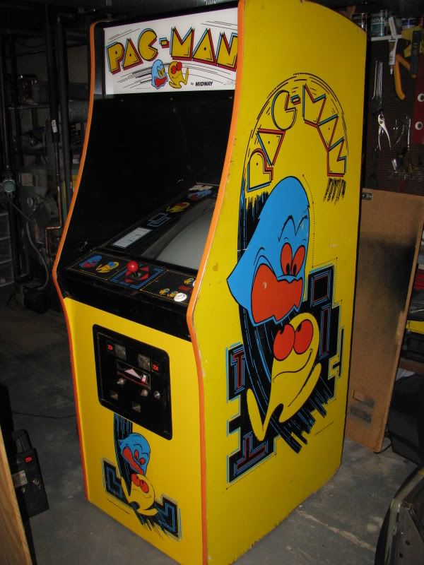

That being said, I'm getting a Pac cab that has pretty decent art that just needs touch up. I'm going to go the easy airbrush route so I can blend the yellow...I don't have a compressor, so I might try that Preval stuff )if it's that cheap) or get compressed air and a $20 airbrush at the hobby store. I used one years ago to paint my Master Chief armor and it worked nicely...just ran out of paint quickly because it just used a little glass jar for the reservoir.

Just picked up some Preval at Home Depot this morning. I'm going to pick up my cab this weekend, and hopefully can get it prepped to paint by next wednesday.
Artwork is pretty good, so I'm just going to try to touch it up and repair the bottom with wood glue, wood hardener, and Bondo. Since I'm going to color match the Pac color using the back door, I'm going to need something like Preval to paint because I don't have a compressor. I'll be sure to add my opinion on it when I get it done.
