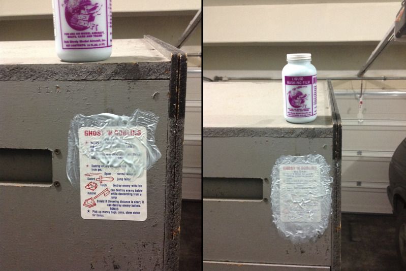

I wrote this on another thread. My Technique using Liquid latex for Masking:
Allow me to show you how I mask at times. Here's my liquid masking Latex technique.

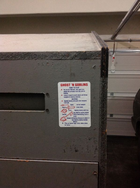

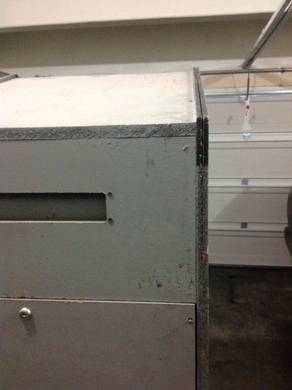

Here is the back of my Karnov Cab that I am restoring.
Now I am going to place My Romstar/ Capcom Ghost 'n Goblins Instruction decal kit on it.
(Guys! Dont worry. I make these. I have tons.)

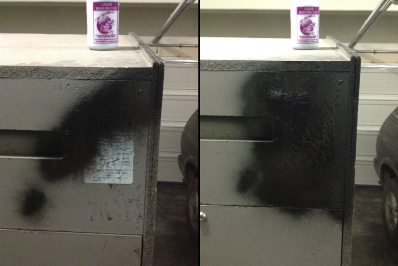

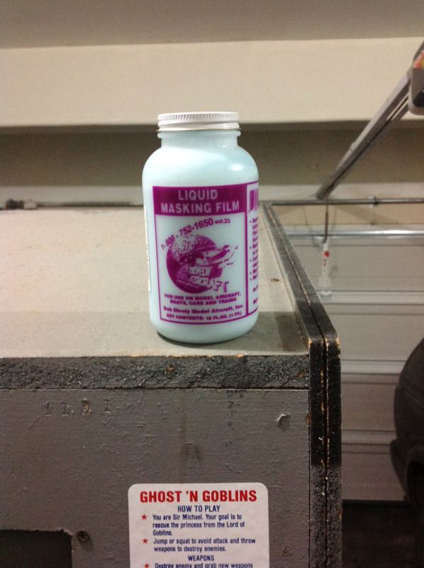

Now I am going to apply a layer of my liquid masking Latex.
I normally apply 2 layers.

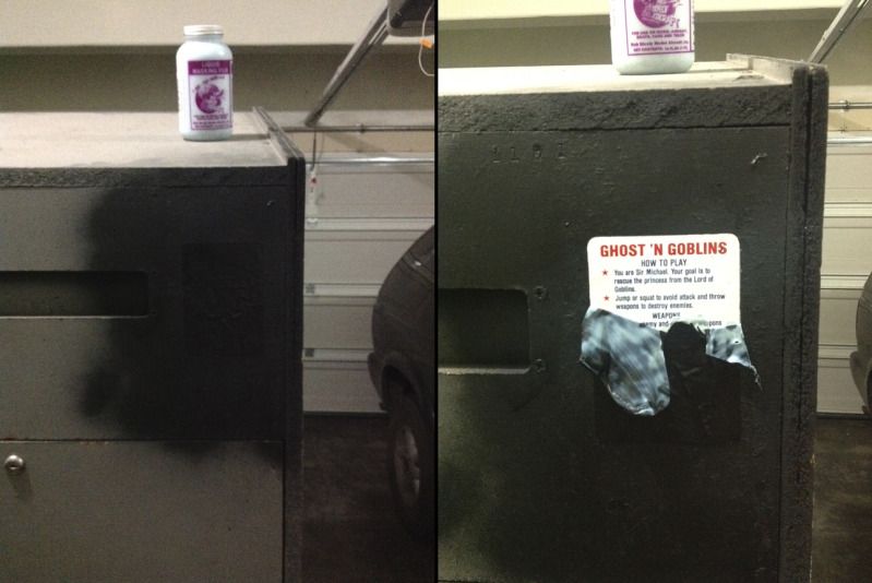

Once dried, I trim what I dont need Masked.

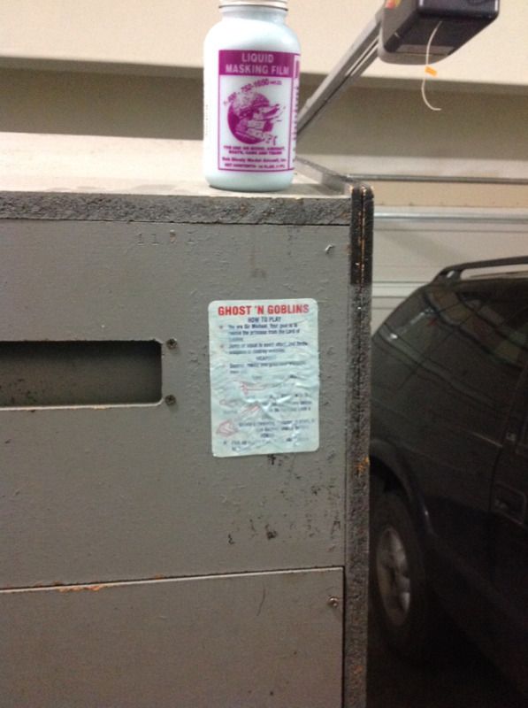

Now I apply the Paint.

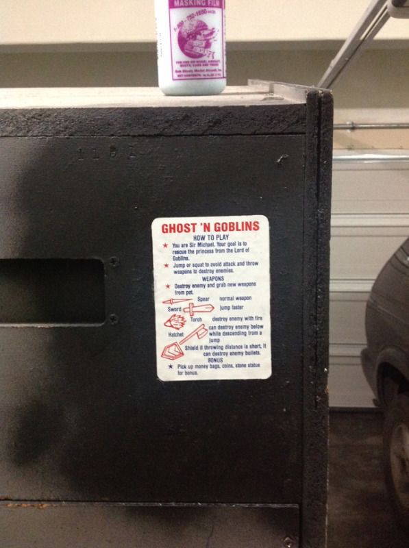

Once the Paint is dried I remove the Latex
And here you go. A basic idea on How I mask my decals. This is not the greatest.
I rushed it just so I can show you guys another technique that can be done.
This is normally the way I do my masking.
Hope this helps a little.

I am glad to see that. This is the liquid stuff that I was looking at. One thing that was stopping me was a warning not to use it on porous surfaces. Have you used it on the artwork side of cabs or just the back?
It will not damage side art. You can test it if you like on any kind of decals.
I mainly use the liquid latex on my model building. I build & paint on high end limited run japanese Resin model kits on the side.
As far as arcade stuff, you'll be fine, Just be patient with the razor when removing the latex that you do not need.
Give it a shot. you can find the latex at any hobby shop.
