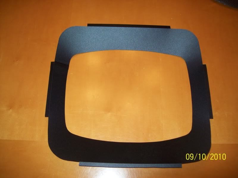

Interesting that this thread popped up. I have been looking for someone to send me a beat up warlords cocktail bezel so i could make one for my machine. It took a while for someone to come forward but here's the final result of my patience
Thanks to forum member Hisnice, even though his was a bit beat up it was still alot easier to make new ones from his template than the method the tutorial shows.
