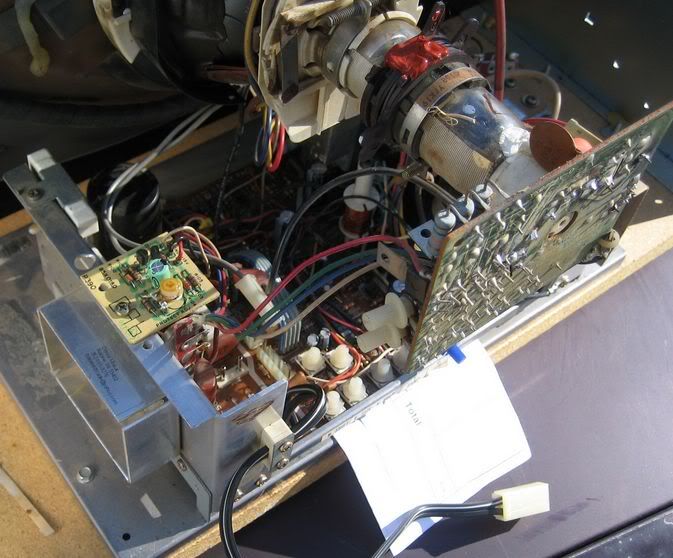

4900 med res chassis have an extra board mounted to the top of the chassis on the left side (when viewed from the back).
The board is small, maybe 1"x1" and has one pot that is glued in place.
The extra board is not always an indicator.
The easiest way to determine is by the IC on the chassis. The standard and medium-res versions use different IC's. Also, if you have the entire monitor, the yoke is different between the two as well.....

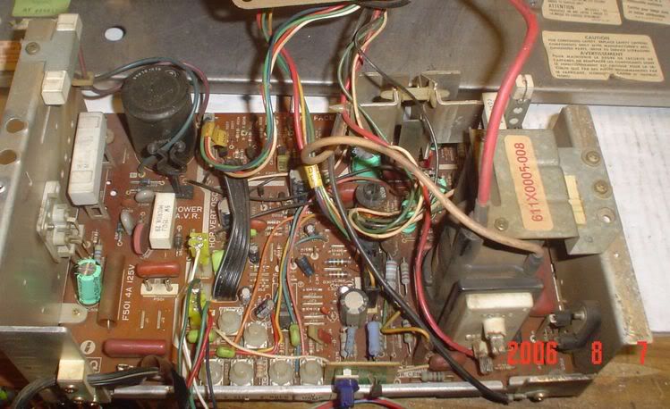

Here is a K4900 chassis. I don't know if it is standard or medium-res (although probably standard as there are more):
Here is a K5515, the 25" version, and a medium-res chassis. It looks just like the K4900, but you can see the little board attached to the right wall. For the K55xx chassis', though, it's not indicative of medium-res, as I have a K5501 (standard-res) with the same board:
