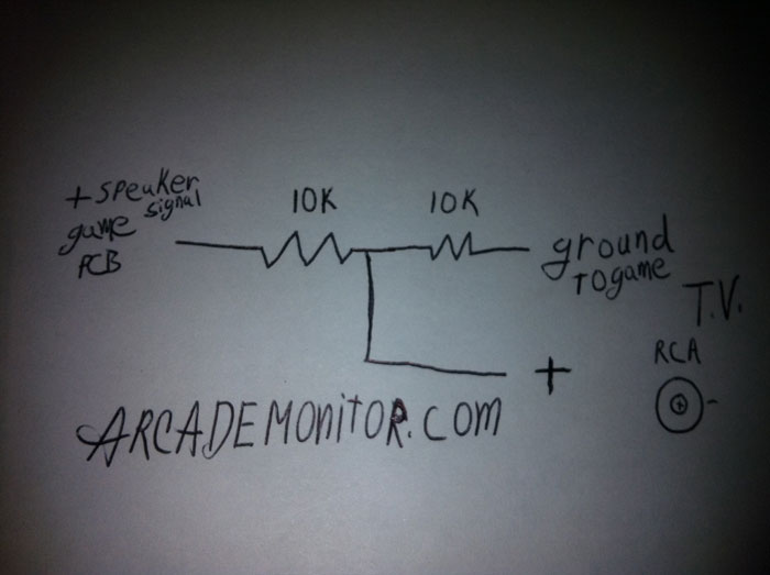

How can I wire Supergun audio so it doesn't blow my TVs speakers?

what'd you wind up doing for this? that's the only thing I never figured out on my supergun.
Check out this art work! Its pretty simple to hook your game to your TV speakers you just need two 10k resistors!
I have no idea what a supergun is, but I'm pretty sure the switch in the upper-right corner is DPDT (not DPST).

basicly a jamma test station in a box that usually allows you to connect a jamma pcb to your TV/lcd/crt/or some sort of monitor.
yeah, that makes absolutely no sense to me.
so you're jumpering a resistor across one side of the switch, and the other is just straight audio, and there's a phono plug that goes in the middle..?
just show me how yours actually looks. lol I'm not the schematic/electronic type.
If that's the case, just buy a line converter. They are inexpensive and a better then the above proposed solutions.
