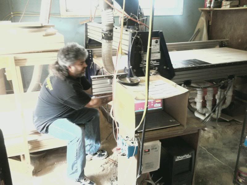

Brett is a great asset to the hobby and does great work. A shot I got of him in action when I was up there about two years ago picking up a bunch of stuff I had him make for me..
Nice to put a face to the words....I like dealing with Brett. Says it like it is, and makes F'N bitchin repros.
Cant wait to get my repro Pole Position cab.
heh I don't have that awful haircut anymore... I quit cutting my hair 2 1/2 years ago.
