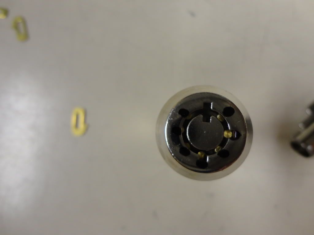

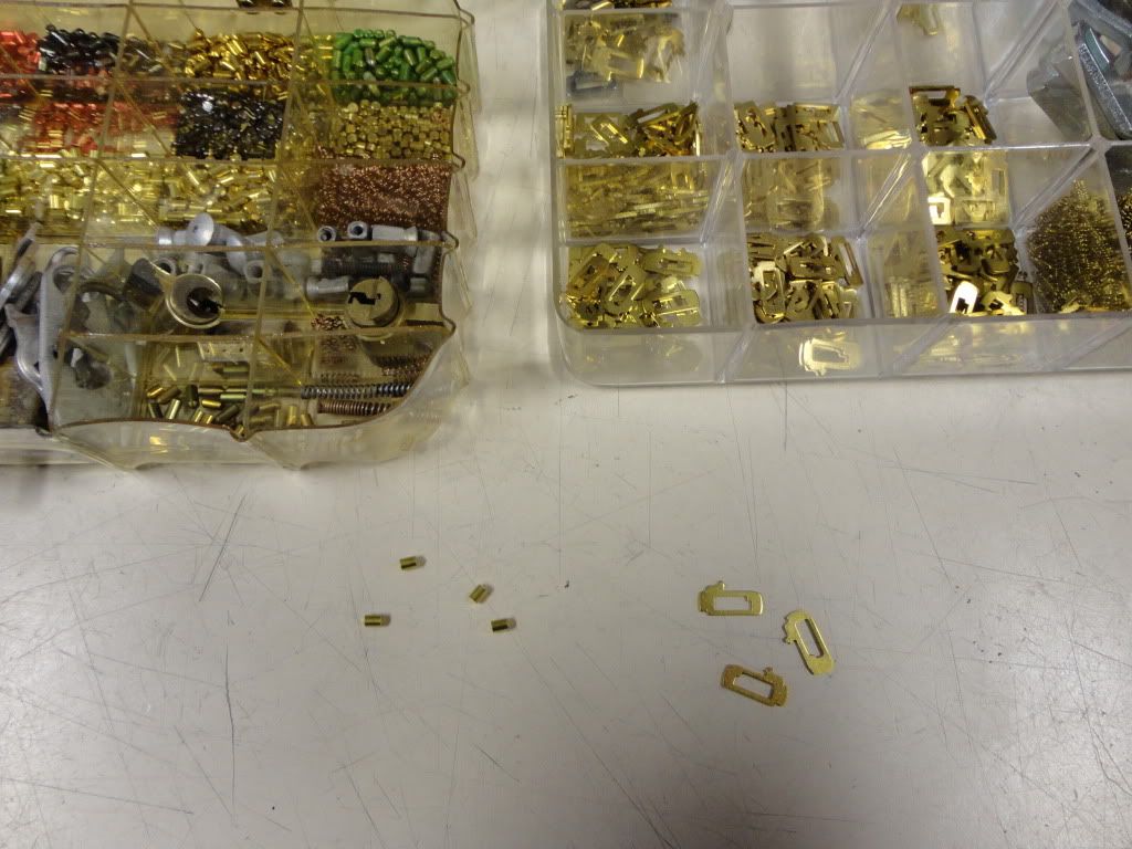

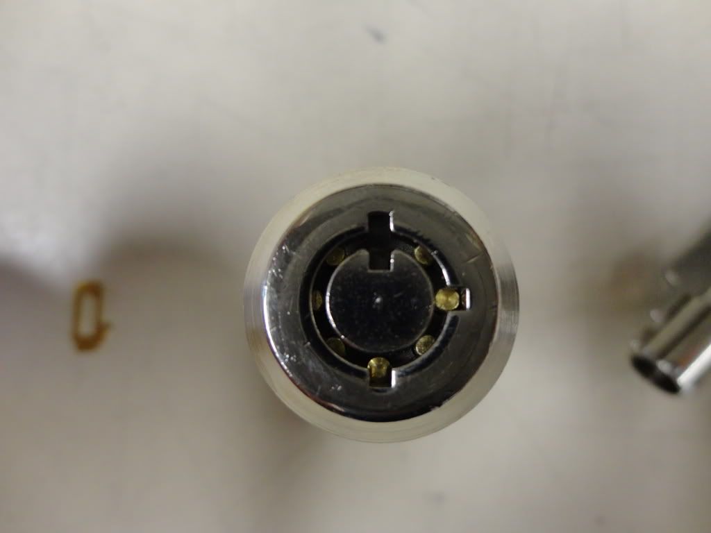

No sorry I am in NC. I belong to (ALOA) Assoc Locksmiths of America and they have a finder. You might try to call some of them. I can drill them out like I posted and you can not even tell unless you look REALLY close. I could post a picture in a day or two how to do it. I just did 2 of the exact same thing for a guy I work with. I thought they were still here in the shop but he took them home already.

I took a black marker and marked where you need to drill the metal away to let the tumblers fall out then you can turn it with pliers, If you drill the holes small enough, You cant barely see that the lock has been drilled. I drilled the metal away and gave my coworker a blank key so he could use it to lock and unlock it.
If yours has anything but 7 tumblers you will have to drill.
